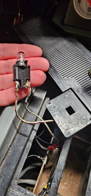

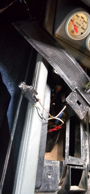

Console gear indicator light socket
GNICETRY
Cat&wife post starter
May 26, 2001
2,128
Anyone?
order the 97' - 04' corvette shift light socket pigtail from any local gm dealership or online. Just google it and you will see it's the same exact pigtail. I had to replace mine earlier this year
Thanks for the info. Lots of the originals were cut back in the day when they stole the cars.
Thank you. You are Mac Daddy. Just got it today and fits great. Actually better than the OEM one. I bought a new shifter ribbed cover and it actually doesn't have the little nub on it that the OEM one had that locked the socket in place. But this one is really tight and stays in place.
