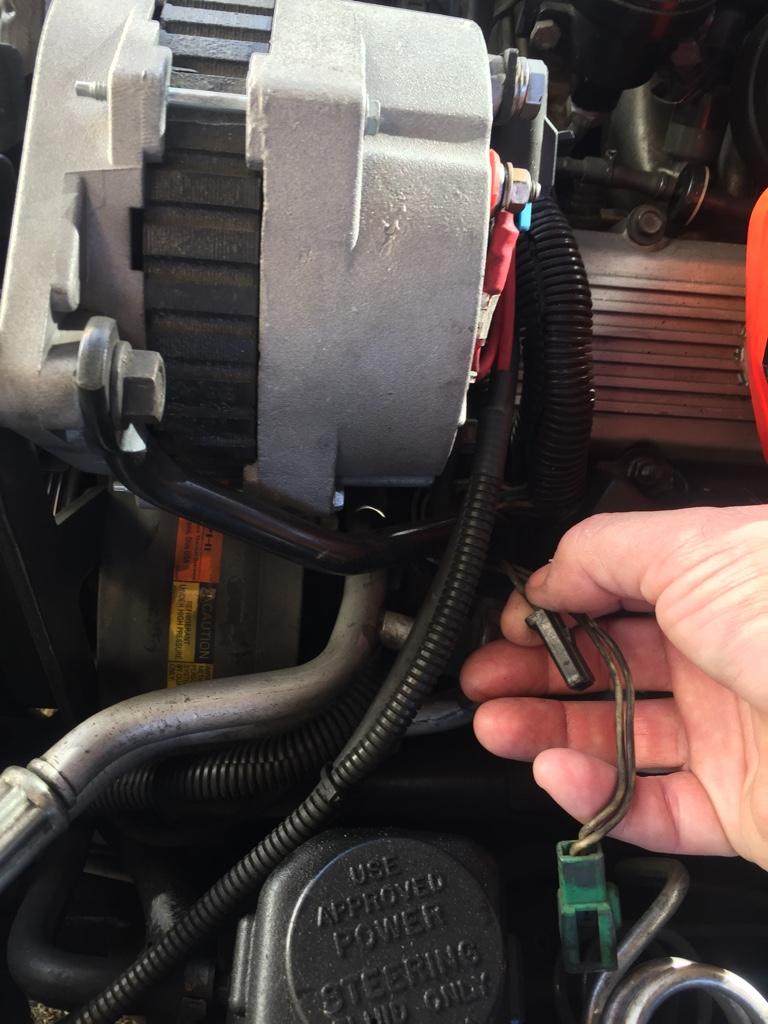

Check the 2 electrical quick connectors near back of alternator and below fuel regulator....
They look like they should go together but should be separated and just left hanging or stuck in wire loom.
One is for the fuel pump and the other for the Tach.
If they are together you may get a max RPM reading
