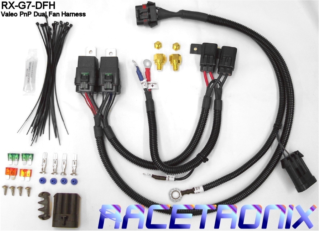

Fully PnP with GM factory wiring
Dual independent circuits for high / low speed selection utilizing factory wiring / control
Weatherproof construction
Dual fused circuits
Dual 40 amp rated mil. spec relays
Direct battery power removes excessive loads from factory wiring, relays and fusible links
Improved voltage supply = improved air flow
Battery nuts w / accessory power taps and body ground upgrade (optional)
All connections soldered
All installation hardware included
I would go with the Racetronix relay set for the fans. All of their terminals are crimped and soldered, most others are just crimped. Anything that Racetronix makes will be better than any equivelant part from another vendor. They have always been about quality instead of high production at a low cost. Their prices are around the same as any other vendor so it's an easy decision, RACETRONIX!
