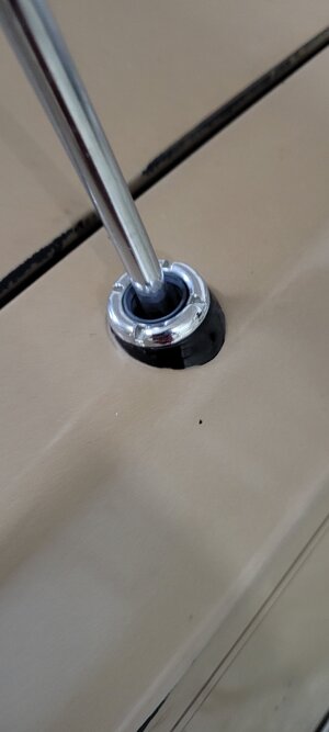

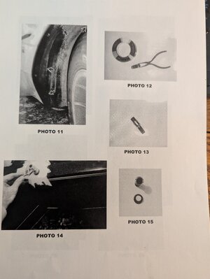

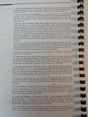

Yesterday at 11:23 AM #1 A ANDYS87 Member Joined Jun 14, 2005 Messages 407 Can someone please post a closeup Pic of the factory 87 gn power antenna - how it's secured on top of the fender? Does the plastic bezel touch the paint, then the screw on part go into it? I forgot how it's mounted on the topside. Thanks

Yesterday at 4:10 PM #2 B BRAD_PADGETT Well-Known Member Joined Jan 22, 2004 Messages 3,584 See step 9 and photo 12-14
Yesterday at 4:11 PM #3 B BRAD_PADGETT Well-Known Member Joined Jan 22, 2004 Messages 3,584 Pics Attachments PXL_20250521_200720503.MP.jpg 1.7 MB · Views: 20 PXL_20250521_200729760.MP.jpg 1.6 MB · Views: 21
Yesterday at 11:35 PM #4 T tysongross Mississippi Mayhem Joined Apr 13, 2011 Messages 49 This? Attachments 20250521_222655.jpg 817.6 KB · Views: 6
