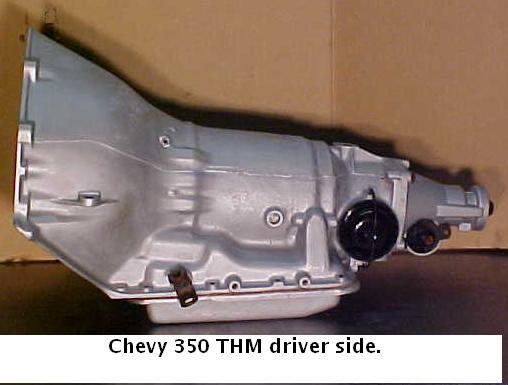

ok so i'm laying under the car and on the drivers side of the trans i can see, in the following order from front to back:
the linkage:
then this overflow looking pipe up the top:
this odd cover with a spring clip (normally means there's a gasket and oil underneath so i didnt pop it off although i was tempted !
what i assume to be the speedo cable ?:

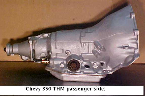

then when i crawl further under the car and get the passenger side of the trans i see:
what looks like the oil lines to the cooler upfront and the dipstick tube?
this wierd looking pink thing that looks like a valve but has a stainless hardline attached to it (oil temp maybe ?) :confused: noted its covered in oil so probably not registering too well either , i'll clean it up !

The wierd looking can you found is a vacuum modulator... it raises presures/ firms up shifts under heavy throttle, low vacuum driving. It should have an air tight diaphragm in it, and no oil inside the line itself.
The reason you can't find the TCC plug: Your 3 speed transmission doesn't have one.
(The guys on this board are used to the 200R4 that comes in the turbo Buicks- You are on your own)...

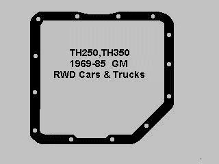

is that to identify it by the pan shape ? its the square one with one corner shaved off, i can try and get a pic tomorrow, but i reckon you may be right about it being a th350 as i found this website with good diagrams etc http://charlietranny.com/GM.htm and it seems to match up prefectly ! (except mines dirty !)
the gasket:
drivers side:
passenger side:
well at least i know what it is !
scrap that, i've just been looking more at that site with all the transmissions on it and looked up the th200 to double check and they're identical to the TH350 except:
It had an aluminum case. Pan shape was similar to 350 THM, but was embossed "METRIC". It had no modulator and there was no removable extension housing
mine has "METRIC" embossed on it.

Not exactly ho-hum... Your first set of pictures show both the vacuum modulator (last picture) and a bolt on extension housing (pictures 3 and 4). I'd say it is a 350; will the pans interchange?
Transmission ID
I've never seen a TH350 pan with " METRIC " on it, but the bolt-on tail-
housing, the modulator, lack of a TCC plug on the left side of the case, the governor cover and the small diameter kickdown cable housing tell me that the pictures you posted are of a non-lockup TH350.
