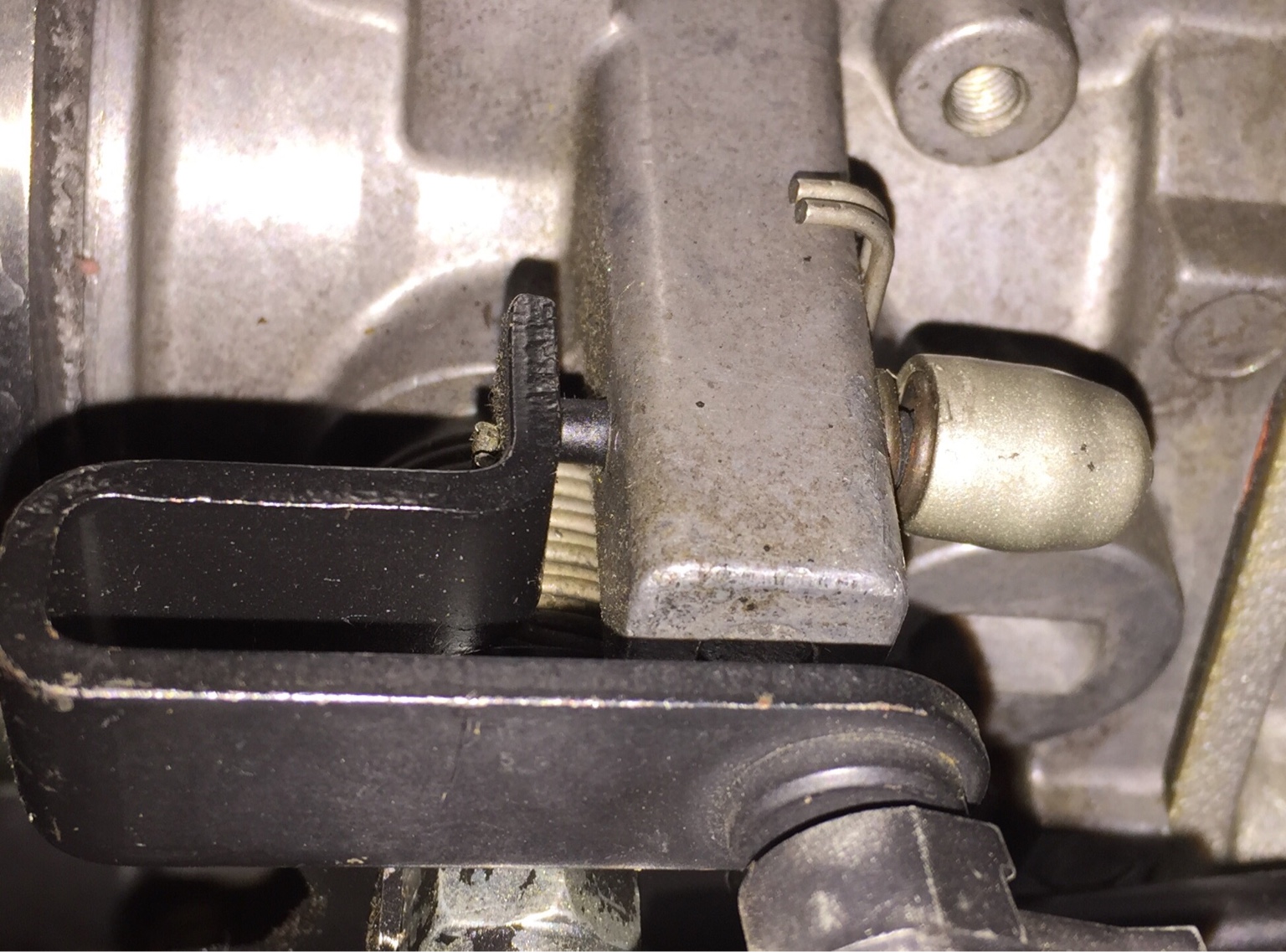

Take a good high quality close up of the minimum air bleed screw setting like this and it may tell us a bit on the setup.

Will do so , Thank You
