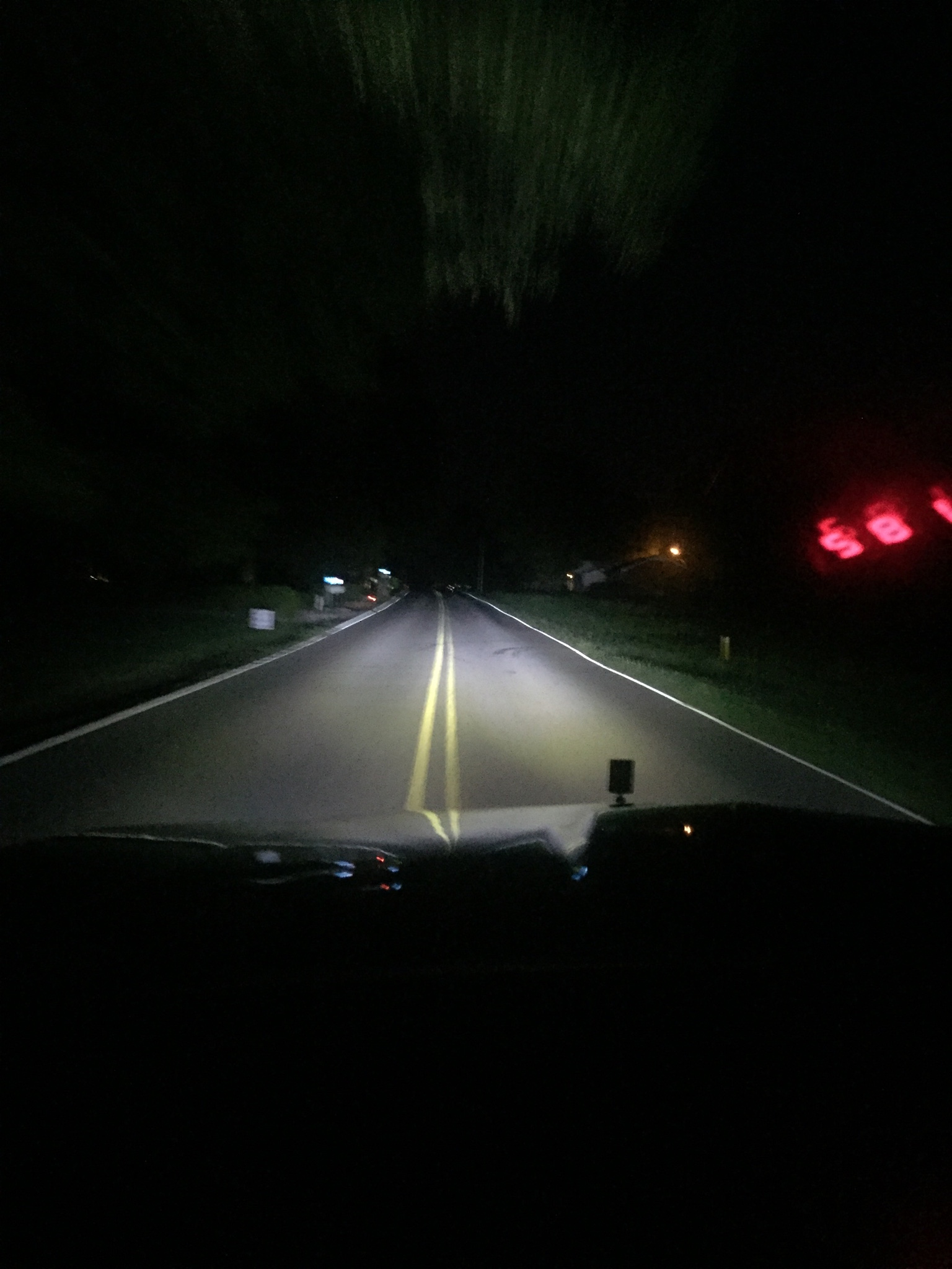

Bought the hella h4 glass and experimented with two led bulbs. Auxbeam and the Phillips led h4/9003
The three sided Phillips are amazing.
Looks fantastic.
Is that with fluted glass lens?
I tried the "Superbright" LEDs in our E250 (composite style lens/9007) but the 2-element light did not put out a good pattern...and I took them out.
The two sides leds had shadows. I knew it wasn't the hella glass causing it.
Put these in and they are amazing. Wanted to share my experiments. Much cheaper than the jw speaker lights. And the hella looks factory. You won't go wrong.
