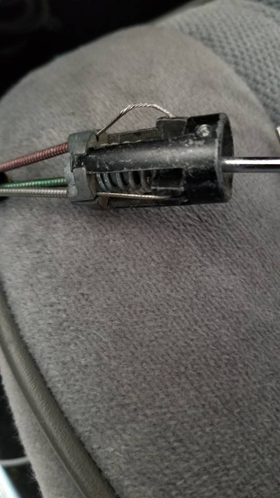

I know this is an old post but I'm having this same issue. There is a lot of slack in the cable and I'm not sure how to go about stretch the outer jacket that is referenced. Any ideas?
that's a buttload of stretch. With that much slack, I'd look into moving/replacing the stop to achieve some preload on the spring.
