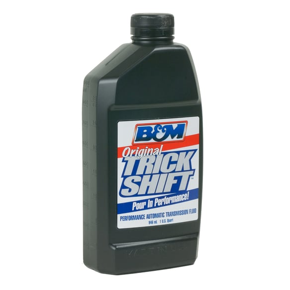

80259 - B&M Trick Shift Automatic Transmission Fluid - 1 Quart Bottle Image
Larger Image
B&M
B&M TRICK SHIFT AUTOMATIC TRANSMISSION FLUID - 1 QUART BOTTLE​
Conventional Trick Shift ATF for Non Electronically-Controlled Automatic Transmission
Part #
this is very good none synthetic and will be compatible with DEX
I have used it for the past 10 years

Thanks for the information.
Ill mention it to the mechanics when they get to it and see what they think.
