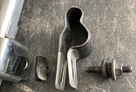

Is this the correct order for installing the parts in the attached pic? Plus, the fan shroud has to get in there someplace.
Trying to figure out why there's another nut on there & 2 washers.
Thanks
flip clip nut and install on rad top plate,
seperate the washered nut from the stud
install fan using the stud ,
then slide ac camp on and install washered nut
Thanks. The washered nut at the end of the stud is removable. There is also a nut and washer on the stud which won't come off the stud. Is that correct? Lives aren't at stake here, but I'd like to get it right.
Correct. Attach the fan shroud to the radiator hold down plate with the stud and non-removable nut and washer (washer towards the shroud).
Put the AC line clip on the AC lines with the holes under the lines and slide it on the stud. Install and tighten the removable washer and nut.

Thanks for the replies. Much appreciated. It's back in. Now to put all the other parts back and hope that the tranny cooler line fittings on the grill side don't leak when I get it running again.
