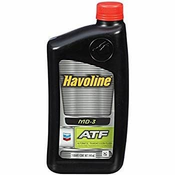

I've been using Havoline MD-3 in my Art Carr 200-4R Extreme for years and tens of thousands of miles without issue. I also add a full bottle of Lucas Transmission Fix to it. Just like I add a quart of Lucas Heavy Duty Oil Stabilizer with my Brad Penn motor oil. Shit's been bullet-proof in both applications. And believe me, I torture test both.
There are other manufacturers who still produce Dex III, you'll just find it under a new name now, MD-3. Because of trademark reasons, they can no longer use the Mercon/Dex III name. I gravitate to Havoline, since I can no longer find Chevron brand. It basically is Chevron, since they're all part of the same company. I used Chevron prior on the same trans for close to a decade and tens of thousands of more miles. When I drop my pan between services, I only have a very small bit of metal on my magnetic drain plug and that's it. I guess I lucked out and got one of his good ones. It only took 3 tries, the first 2 burnt up real quick.
You can usually find Havoline at Rural King for a really good price.
