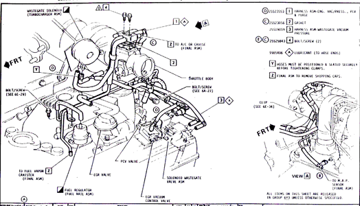

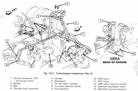

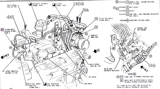

Putting a turbo back on my 1984 t type have all the vacuum lines hooked up besides one wondering if anyone has a diagram or picture of all the vacuum lines on the turbo
