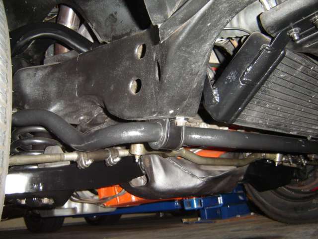

I do have a torque limiter on the drivers side of the engine going down to the frame with solid rod ends, I suppose that could be it.

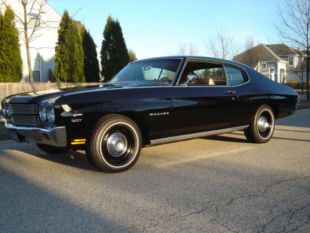

As for pics, here you go :)
hey its the car craft twin turbo sleeper march 2011 AWSOME RIDE!!!
