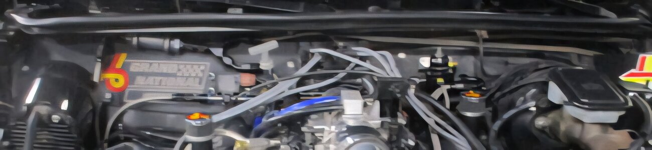

Take a picture of the reg on the rail and link to it on their website.

Sounds like your reg might be the choke but hit us back with part info later.
