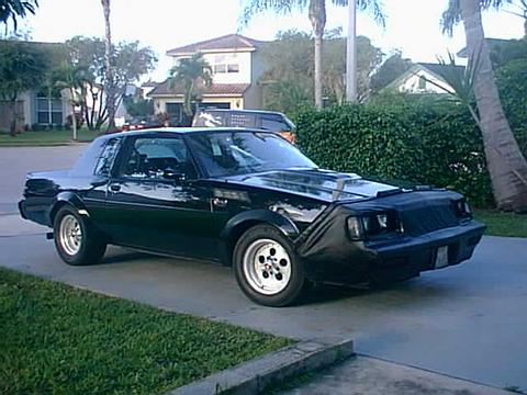

I was wondering if anyone has pics of these tires on their car. I am currently running 215s :rolleyes: and though it is fun for smoke shows, :cool: I need more tire. I was also wondering if I will have any problems with 295s rubbing. I want to lower the car an inch and I will be running GNX flares so I cannot roll the lips, will I be able to get these tires to fit and what backspacing will I need? :confused: TIA
I ran 295/50-15 Hoosier Quick Times on my T-Type for a while. 8" Draglites with 3.5" backspace. I had to roll the lips, but the Hoosiers seemed to run big for the stated size. Hope that helps.
