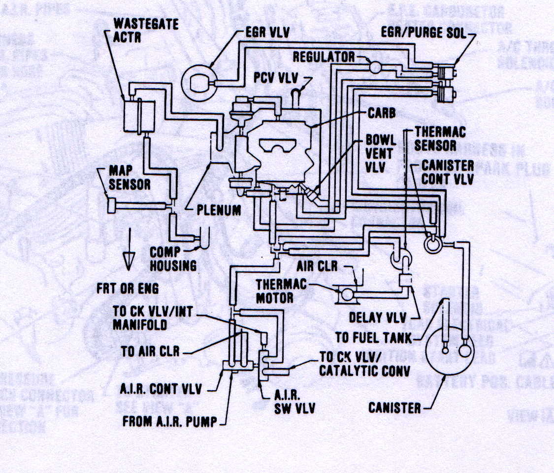

I am finally installing the carb and turbo I rebuilt on my stock '83 T-Type... I've already deleted the smog pump and corresponding valves. The question I have is in regards to the vacuum lines that connect at the rear of the carb and the electronic modules they connect to. The vacuum lines also connect and run through hard line just below the valve cover, coming up in the front of the carb... Some of those vacuum lines connected to the smog pump valves. So my question is what are the electronic modules(pictured) and the vacuum lines(pictured) that attach to them and can I remove them and cap the nipples on the carb, without causing problems? Any help would be greatly appreciated, thanks

I do have the diagram that you posted, it's in one of my repair manuals... i'll have to check if i have one on the shroud that is different. since i've removed the pump, canister, the valves, thermac sensor, i'll be adding my own cold air intake... pretty much everything in the bottom right side of the diagram i've removed. i was thinking most of those vacuum lines would now be vestigial or maybe they were pretty useless in the first place, only in place to satisfy epa standards? i do have the egr valve in place still because i was told if i were to remove it i would have detonation... i've heard these quadrajet electronic carbs are very specific with the vacuum, bleeds, jets... and can be temperamental if slightly altered, so i'm weary about removing too many vacuum lines. i'm pretty satisfied with how much the engine compartment has been cleaned up after i removed the smog shit. maybe i'm just getting too nuts with removing these other items but i thought since i was at it, might as well get rid of all that i can as i try to make my t-type pretty and easier to work on :) so am i understanding that both those modules on that mount are egr purge solenoids?
No, just one is for the EGR valve. The other purges the charcoal cannister.
The carb is the source of vacuum, so capped off any ports that are no longer being used.
Good advice is don't remove anything unless you know what it is and what will change. :)

Those are OK to remove. They are gone on my '83 T Type. You just need to make sure the right places are plugged. The smog put air into the exhaust (at different places) so the catalytic converter operates better. If you have a converter with an air tube, it might plug without the smog pump. Without the canister, you might smell gasoline from time to time.
EGR is tricky to remove right, and offers no benefits.
