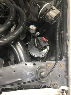

your worried about the gas smell? wait till you see the oil stains it leaves. JK, check the return line that is supposed to be terminated into the charcoal canister, if it is venting into nothing, get some kind of filter for it , as brad had mentioned above.
Mine did the same thing, the return line to the (removed) charcoal canister was the culprit. Grabbed a small foam filter to plug the hose, smell was gone.
Don't cap the hose completely, it needs to breathe otherwise the tank can't pull in air and you'll end up hurting the fuel pump.

Does it have this? (minus the gauge)
Looking under the hood from right in front of the left headlamp.

I just put an online fuel filter on my open vent hose(charcoal canister removed) and the gas smell stopped. This works.
