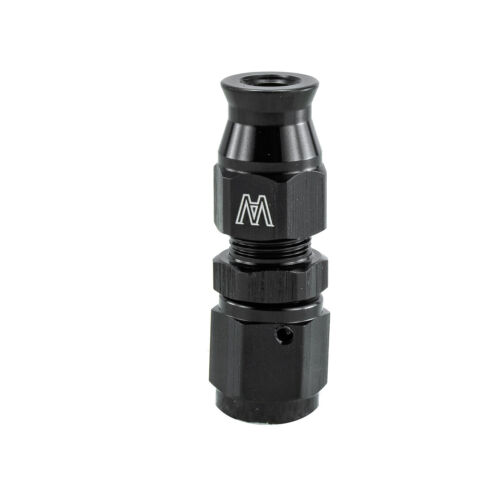

Hi this Fitting will going between stock style oil feed flared line into turbo?
I found mine at the local Ace Hardware.
They have a huge selection of brass fittings.
I use this fitting with the stock oil feed line.
I just cut off the factory flare off and de-burred the 1/4" feed tube well so the compression fitting does it job. I did this with the line off the car so I could blow it out and ensure it was clean. I couldn't get the inverted flare fitting to stop leaking and we use these compression fittings at work to build remote grease systems. That was 3 years and 10k miles ago, not a single drop of oil leaked and I can disconnect it and re-connect it with no fuss.
Here we go
