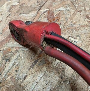

One thing to check is the positive wire from the Alt to the battery where it connects at the battery terminal. This was causing all kinds of gremlins for me last week. Try wiggling this wire and see if the voltage light flickers.
