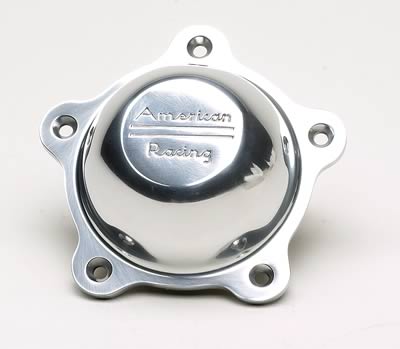

The torque thrust 2 wheels from american racing have a center cap that looks almost the same as the greg weld wheels cap but it has a bump in to clear the dust cap. I need to get the measurements of the star patteren of the cap to see if they will be close to fitting my wheels since they have an allen bolt on center cap. I can order them without a logo on them and transfer the greg weld sticker over to these caps then my problem is solved!
The cap for the torque thrust 2

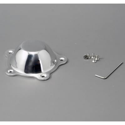

My wheels showing how flat the cap is. I won't have issues in the rear though.

with the cap smashed right to the nut even after you see the nut mold, unfortunatley it does not work with these.
It appears the AR caps will work. I have measured and center of each hole is 2 1/4 thnx 87turbottype:)
Thanks for that info. These would be the ones that I would order then
