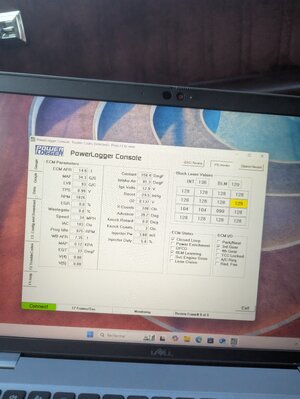

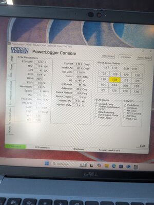

My car has a backfire. I can't rev above 2000 rpm. I checked the MAF, changed the crank sensor, knock gauge, ignition coil, ECU, chip, and injectors. I have a Scanmaster and Powerlogger. What I see is wrong is the spark gap, which goes from 25 to 50 degrees. I guess that's my problem, but how can I fix it?
I hope the photos are clear enough. the first 2 photos in the park and the others in cruising. fuel press 38 Cruise and Load 43

My car has a backfire. I can't rev above 2000 rpm. I checked the MAF, changed the crank sensor, knock gauge, ignition coil, ECU, chip, and injectors. I have a Scanmaster and Powerlogger. What I see is wrong is the spark degree, which goes from 25 to 50 degrees. I guess that's my problem, but how can I fix it?

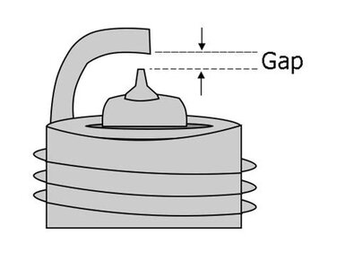

When you say Spark Gap most of us will think Pic 1.
You might mean your spark advance is jumping from 25 degrees to 50?
50 degrees is higher than necessary for the car during cruise, 44 is plenty during the low load rpm cruise. 50 degrees can create a bucking feel from over advance.
You could have a crank sensor to ignition module issue, ground issue etc. Try to log the rev limit and post that.
