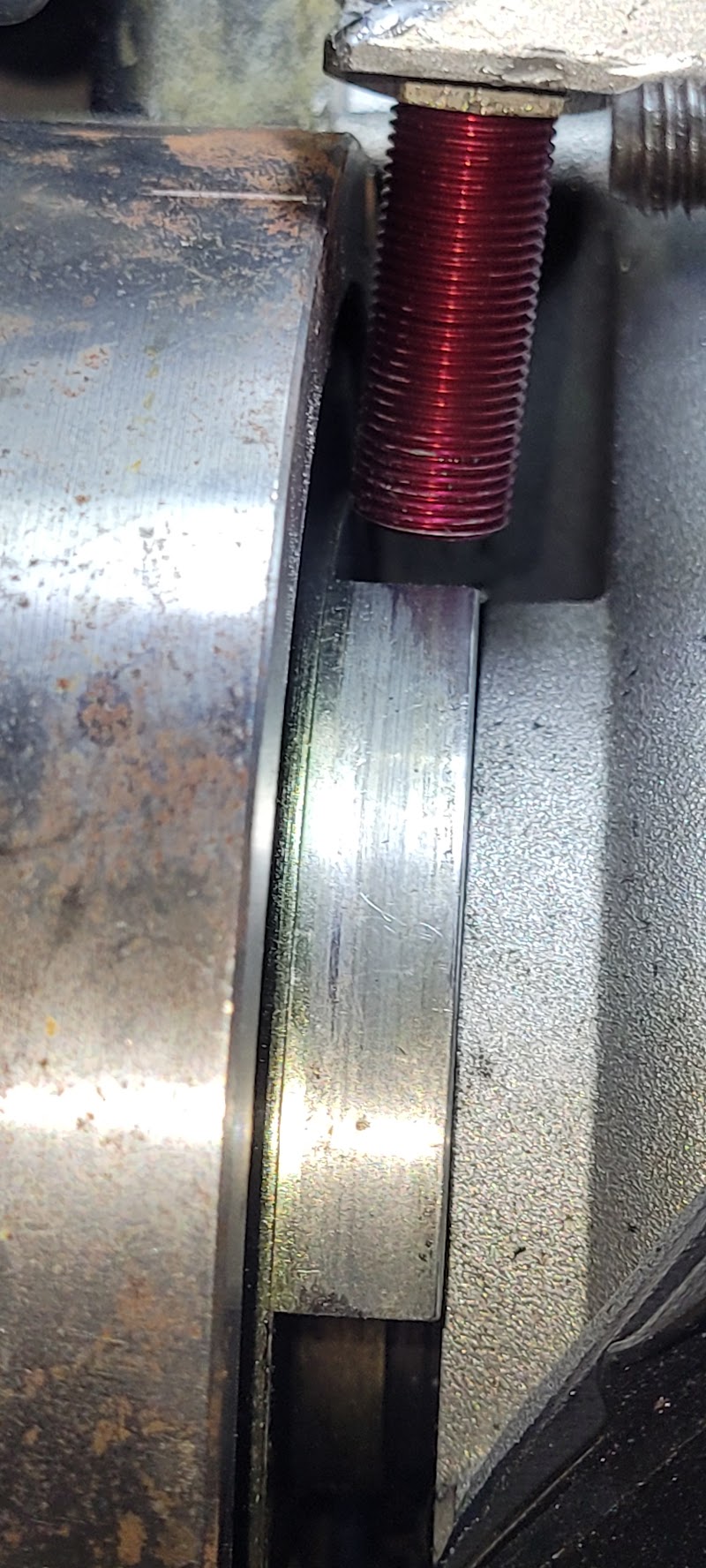

Replaced crank sensor. No change. Suspecting crank sensors from parts stores were not reliable anymore, acquired a hall effect sensor that's used in motorsports and installed that with a custom bracket.
Changes to the tune? this sensor is inverted from the stock one, so It required some tweaks to the wheel config in Tunerstudio, but now I have a modern high quality hall effect sensor instead of having to gamble on Chinese repop OE style sensors.

The fancy hall effect sensor? Completely unnecessary, but I'm keeping it.
