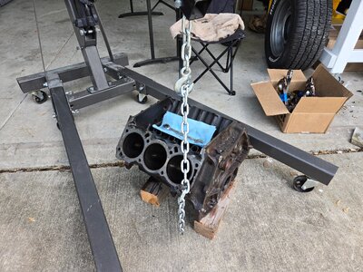

The engine parts have been dropped at the shop. At first glance they dont think the bores can't remain the way they are. Likely going .020 over. So new pistons will be part of the rebuild. Short block will consist of a new GN1 Performance crank, stock rods with ARP bolts, new forged pistons...etc. cam choice is still to be determined but I'm looking for a roller cam close to stock grind.

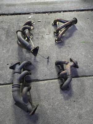

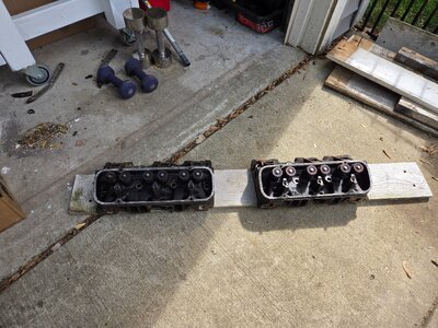

This car came in a state of disassembly that I'm just starting to get my head around. I dont think I'm missing much but I am definitely missing the exhaust crossover pipe. It did come with two sets of headers though. I'll likely go with the stainless ones. Where can I find a crossover for them?

we have venders that will set you up with a set of headers and a down pipe that will fit with no conflict or fabrication needed that won't crack leak or burn a hole in a plastic finder.
your probably saying to yourself I don't have money burning a hole in my pocket. But trust me you will thank me after trying to fix old OE our CRAP Chinese three times.
Use the stock exh manifolds, have them welded if needed.
Use your original lifters with the stock cam in the same order they were in, if not go roller. If roller you need to cut the exh guides. Springs ect.
Is the crank internal balance? You will need a TA balancer and flex plate
AES should be fine, hopefully they have a Trq plate and V6 bob weights to balance the crank.
You really should have stuck with a stock crank, good line hone with main studs.
Can you show pictures of the spun bearing and crank?
In order to use the stock manifolds I'll need a crossover pipe, one never came with the car. That should be easy enough.

You can find a stock cross over.
