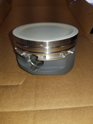

You are over thinking this. If you run pump gas you will denotate and need to run forged.
I have bought several second hand NEW sets or slightly used for around $400-600
