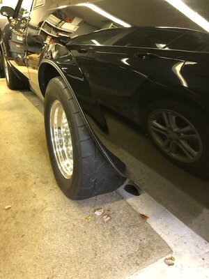

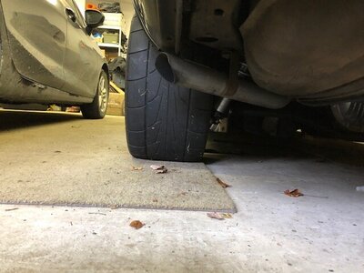

Just purchased the factory replica gbodyparts.com Wheels. Rear wheels are 15 x 10 with 4 inch backspacing. Anyone know the biggest tire you can put on these? My fenders are rolled. If anyone has these's Wheels with rolled fenders what size are you running?
Not that big. you have air bags ?? 10" rims really make a 275/60/15 huge. Had a friend that ran radial T/As on them . They did stick out some. I am sure others will chime in as far as tire sizes. Good Luck
I'm currently running Nitto NT 555 R Tires 275/50R15 from Summit racing on a 10" rim ( might be 9.5" wide)
Backing spacing is 4.5" Have QA1 now but also ran with springs and air bags
Tires are 26" tall might be issue with 28' tall

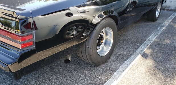

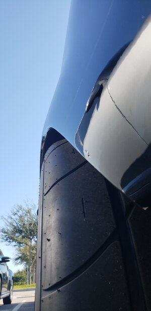

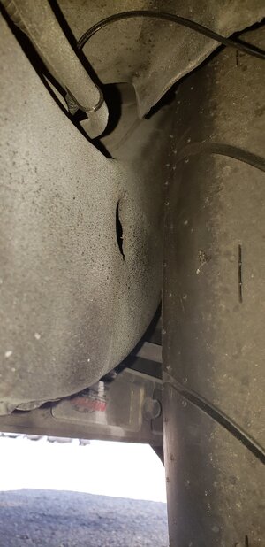

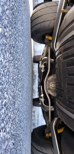

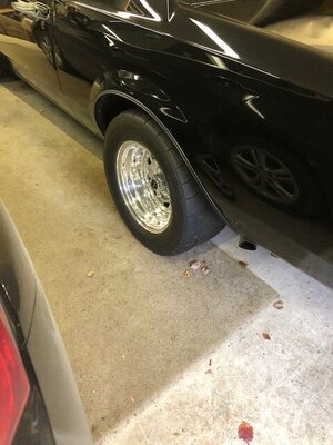

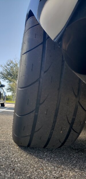

20191121_111502.jpg20191121_111426.jpg20191130_111227.jpg20191130_111223.jpg20191130_111331.jpgThanks for the pics looks great. I have the Gbody parts replica wheels. 15X10 4.5 back spacing. Fenders are rolled frames (not) notched.
I put Micky Thompson ET street SS 295/55/15 on and they fit perfect. No rubbing the fenders or frame. No airbags either. The inner part of the tire is about 1/2 an inch from the frame. Seems every Buick is different when it comes to the alignment of the rear end. Guess I got lucky. I keep reading and hearing about this size tire rubbing on other cars.
