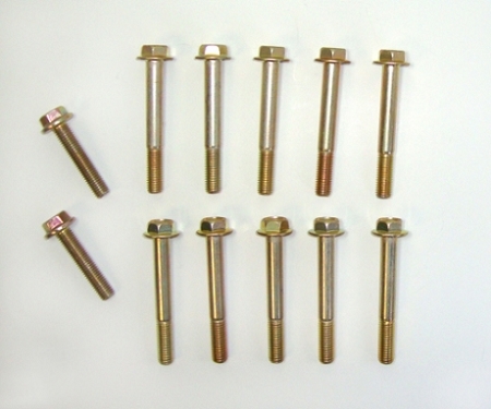

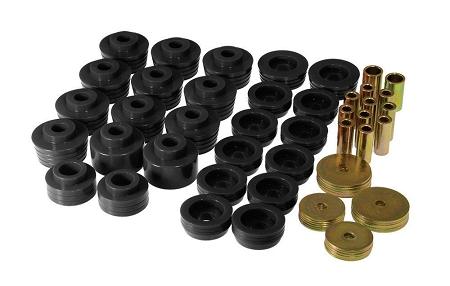

I looked around, though I'd prefer to buy from Kirbans, Mike Montes has the same rubber kit with bolts for almost half the price. $150 from Mike's including hardware! Versus $250 from kirbans for the kit $40 for bolts. Does anyone have any experience with Mike's? Mike's also has a prothane kit for $150 and $27 for the bolts. I can't really decide between the rubber or prothane, but I think either will do a great job. I'm leaning towards the rubber kit, as I have a few bushings actually missing from factory and few that are totally disintegrated. So I'm sure I would be happy with all bushings including GNX #5 being added. I do not want polys.

Just ordered from Mike, gave him a call and he has the rubber bushing kit in stock.
$181 shipped to my door!

Mounts came in the other day, Mike's Monte rubber kit with hardware is a great value. $180 shipped, email verification on order and delivery via ups. Great guy to deal with.

I followed this and had mine done in a couple hours while taking beer breaks. Used energy suspension polyurethane kit.......had a thread with pics, but no more after the site took a dump
Many of my bushings are missing from factory or completely disintegrated.
My question is for bushings #2, 3, 4, 6, 7, does the big bushing go on top and the small on the bottom or vise versa small on top and big on bottom?
