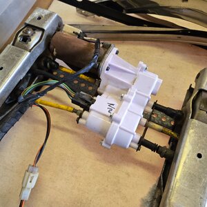

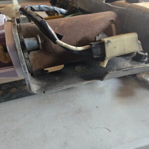

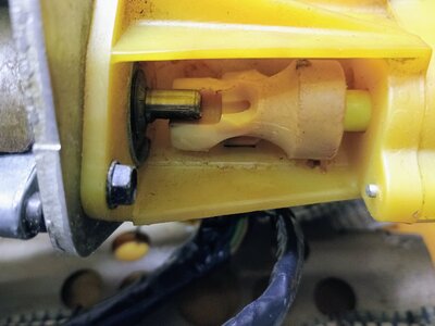

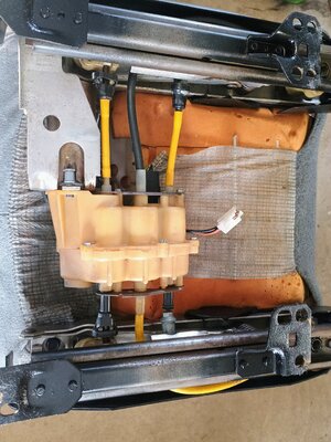

Are there instructions for troubleshooting my power seat? I think it is something in the motor or connection cables. Does anyone sell these parts or are they available aftermarket (last choice). Thanks for the help
Paul
What year is your car? The 1985 and older have one motor and a transmission which are all going to crack and fail.
The 1986-87 has the different motors.
There are mid year changes as usual.
I'm not saying its the drive unit, just letting you know to look and see what you have.
Oh ok. It's an 86 and has one motor, if I remember. I should take a photo since I have the seat out so I will post that tomorrow.
That plastic transmission housing if original will soon crumble.
