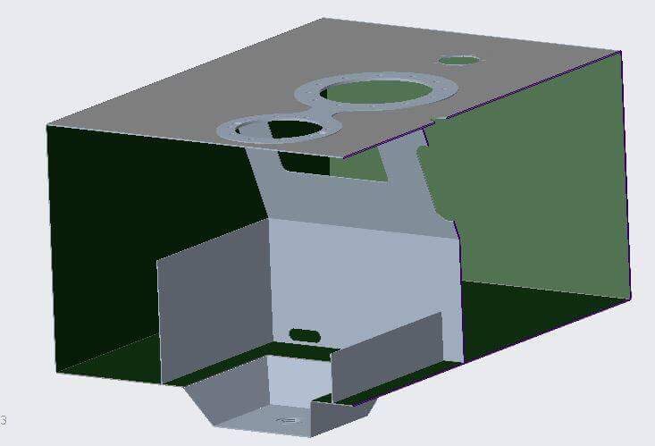

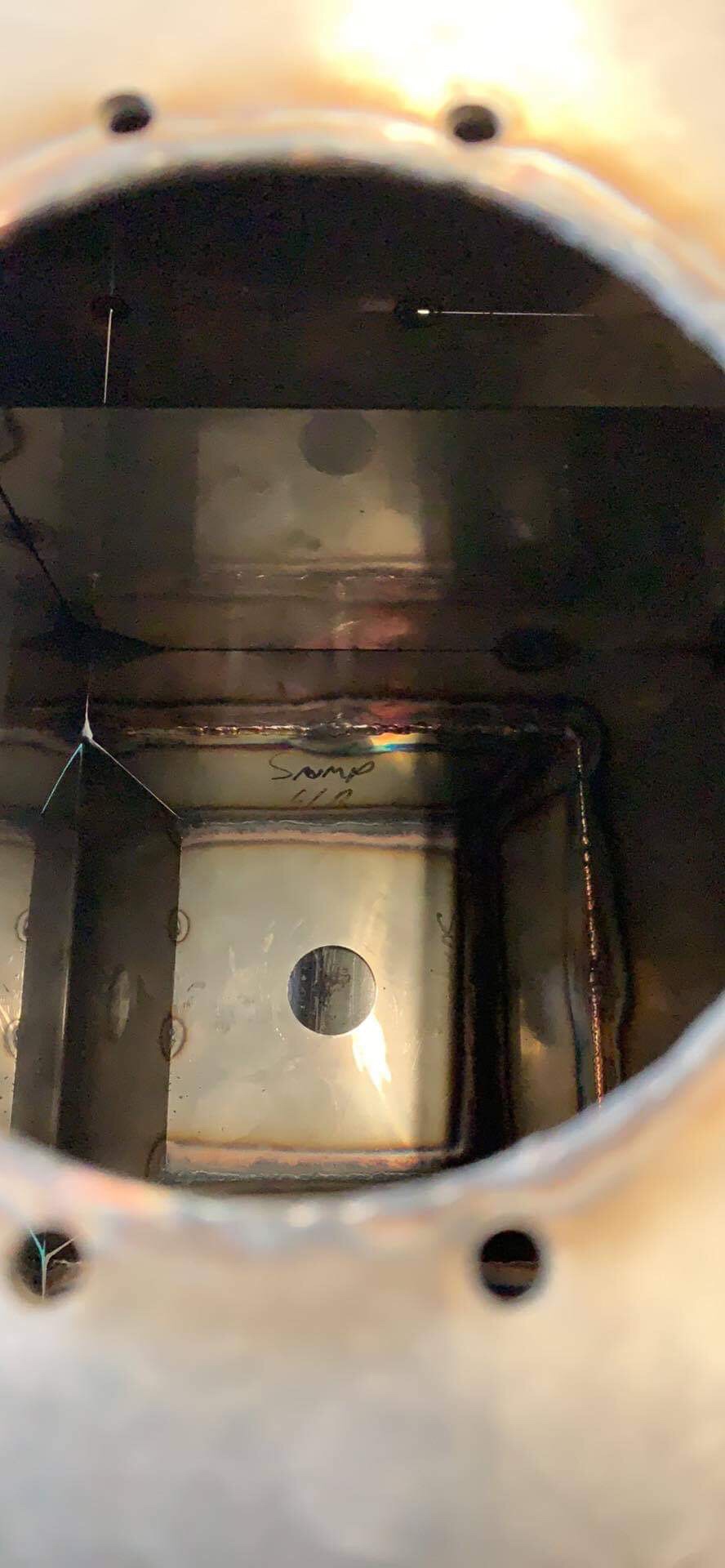

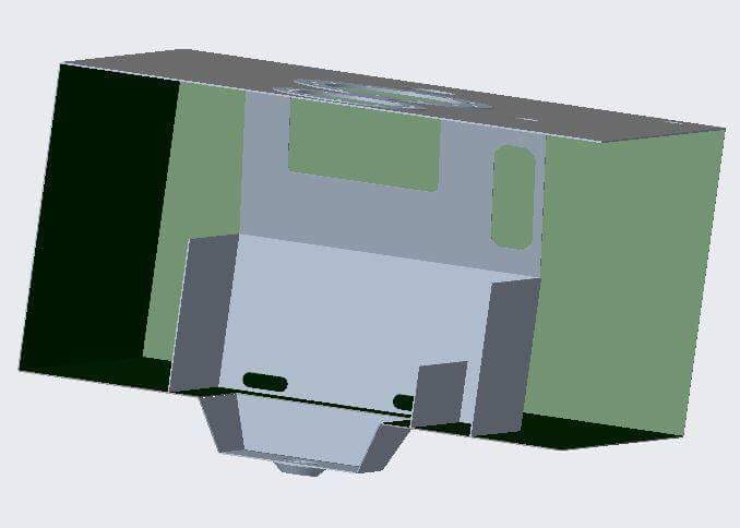

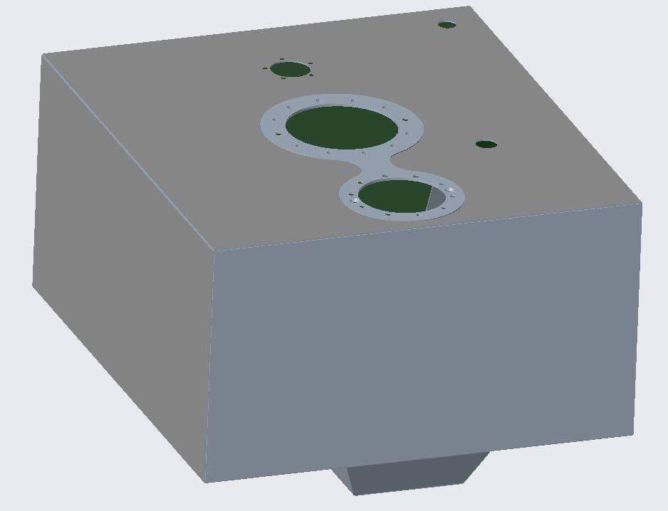

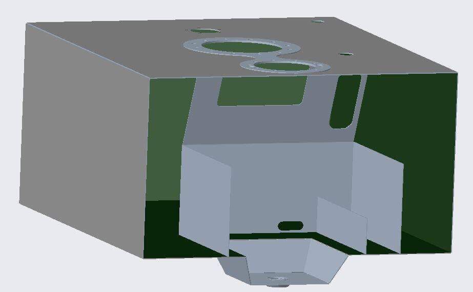

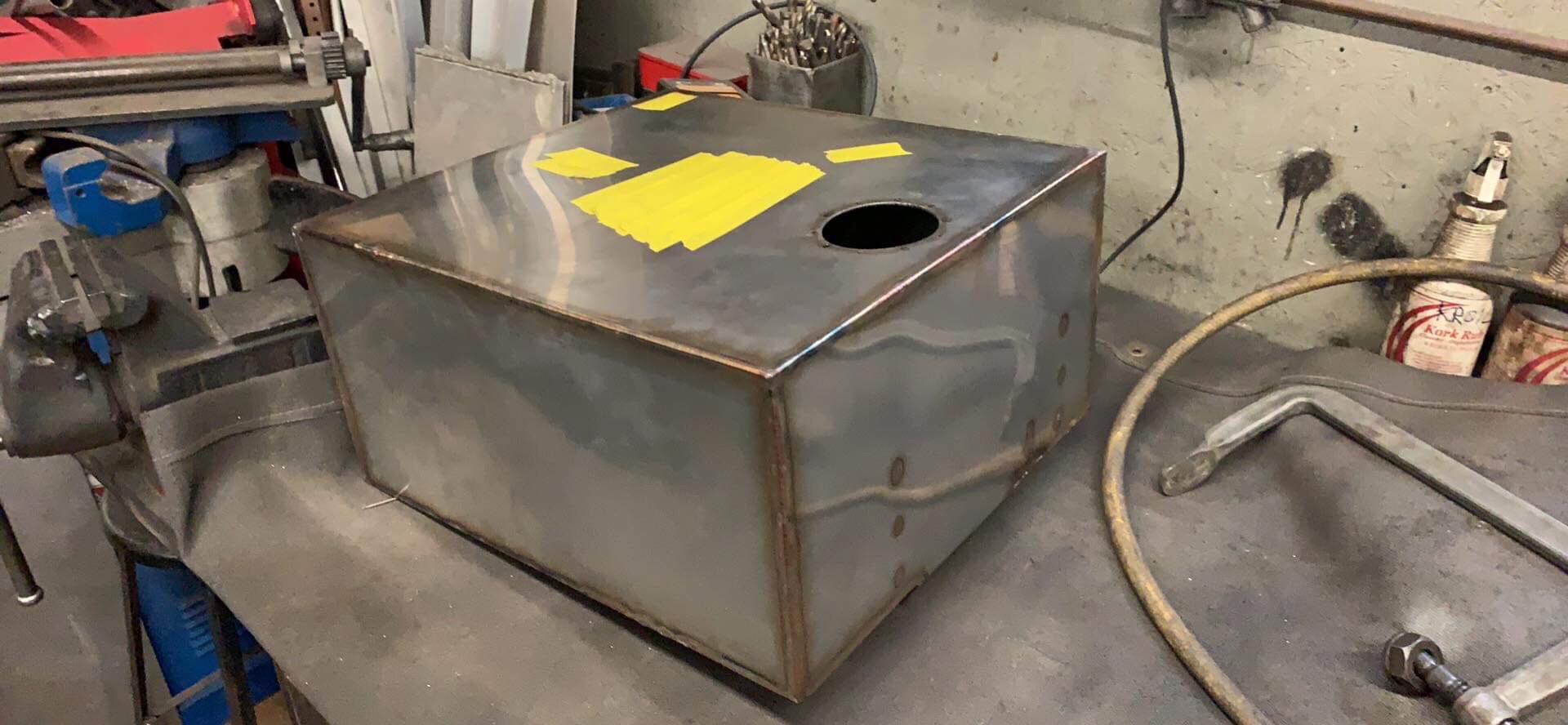

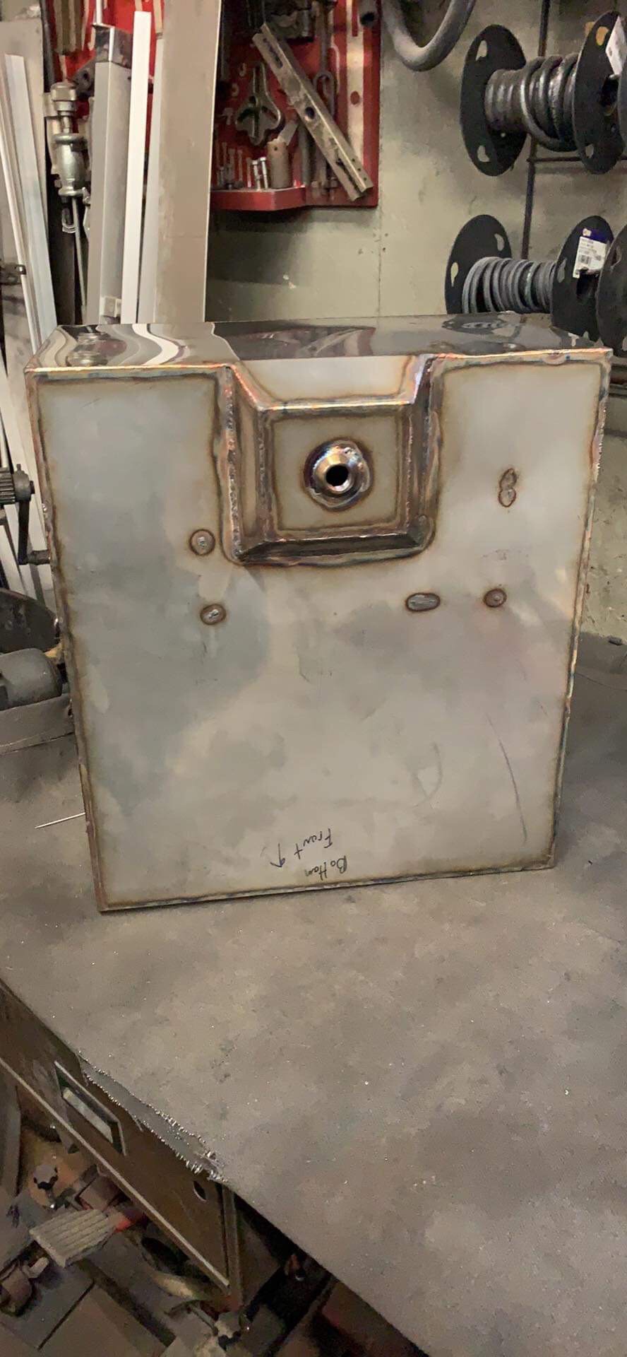

Decided to take on another project. Looking at constructing a stainless steel fuel cell with an Aeromotive cell mounted brushless gear pump, an integrated baffle box to keep the pump submerged in fuel. Basically took some of Aeromotive’s design but tailored it for me and made it more robust for the thin wall section stainless and heavy pump hanging from the top. I also plan on running a special venting system that will keep a small positive pressure in the cell to help control moisture. Will be getting material cut soon.

Yes on the pump, and they sell that pump as a direct in-tank mount. It just makes it easier to have the pump integrated in the tank. The sending unit and fill cap are standard items available from summit. The sending unit will be a GM 0-90 ohm 9" long unit.

This will be a 15 gallon trunk mounted fuel cell to replace the old 15 gallon un-baffled cell I have right now. The mounting will be directly to the floor with 4 mounting tabs on the cell(no straps). I have not had a stock set of fuel lines in my car for 18 years now so the intent is to run all braided -AN line and fittings.
Aeromotive already makes an Aluminum cell with this pump in almost the exact same configuration and a few other smaller versions but being made from aluminum it will probably not play well with M1 Ethanol.
As of now I don't plan on making any more than 1 copy. Reason being is that I don't have a feel yet for the raw material pricing and the fabrication cost to weld it together.
