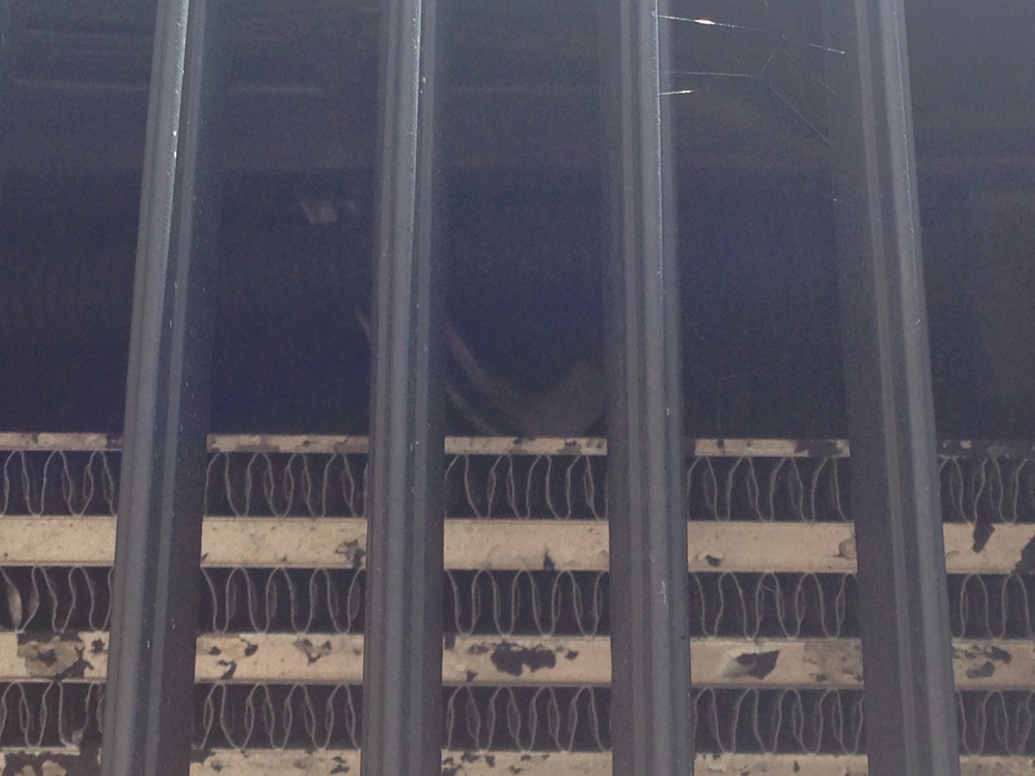

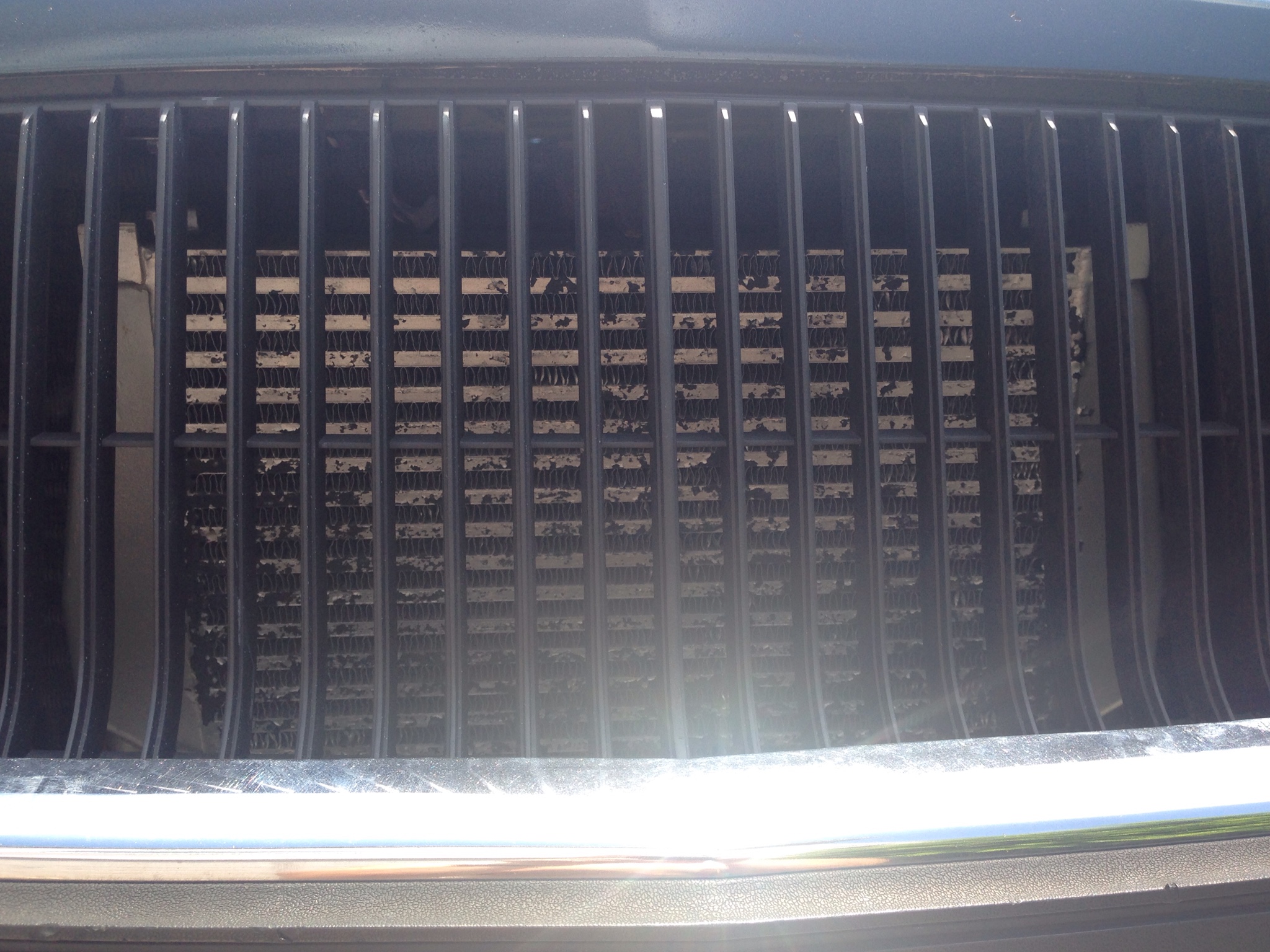

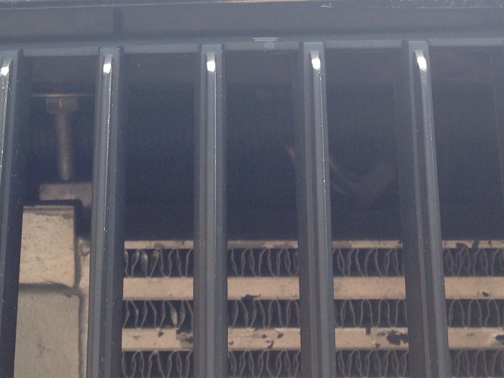

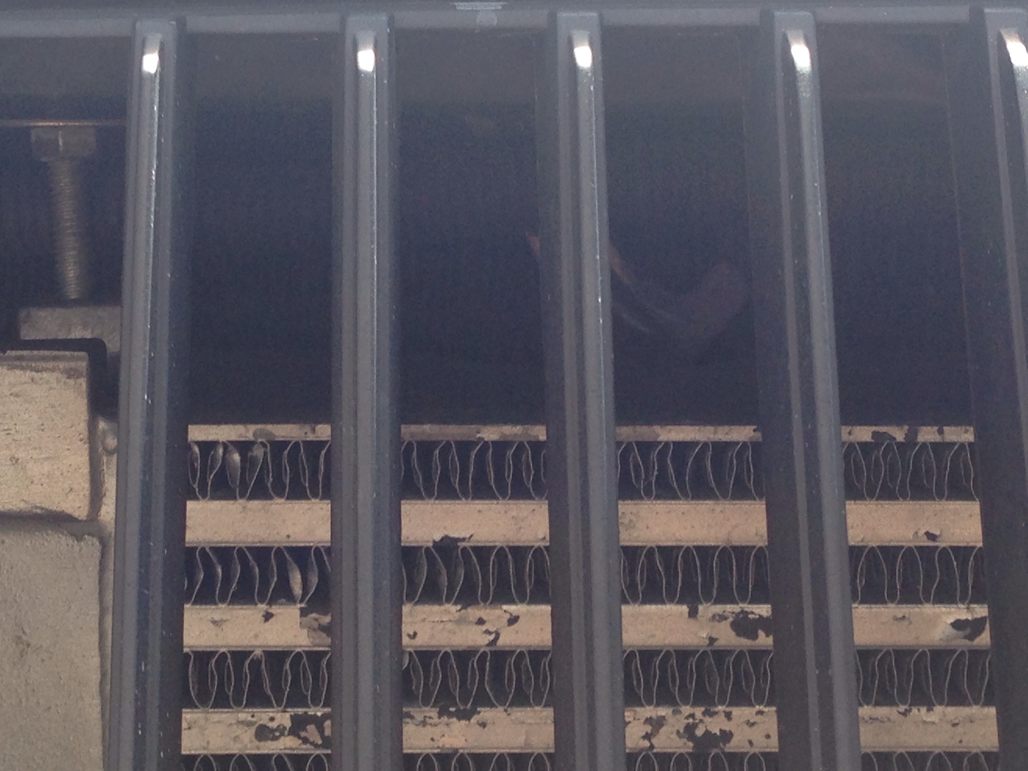

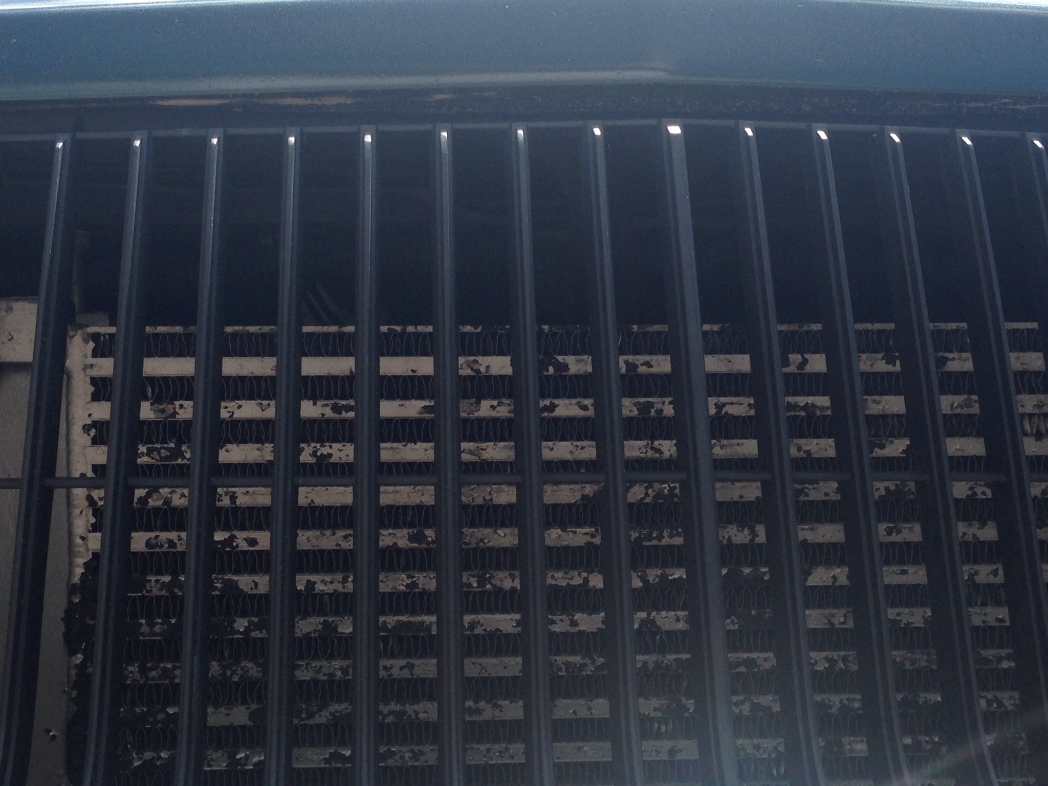

Does anyone have a picture as to how it is mounted in the car? Mine is mounted up high and interferes with the hole for the hood safety latch to where I cannot use it. Do I have it mounted in the right place? All hoses and pipes fit like they should.
That was as high as I could mount mine without the issue you speak of. I bought mine used and it was slightly dented down in this area.
If you notice, the studs that mount it to the radiator support are probably sticking up almost 1.5 inches. I had to have to majority of the threads below the core support, the negative effect is your intercooler pipes are lowered as well.
Thats the damn problem right there. Thanks guys! I will have to remove it and lower it a bit somehow. Thanks
