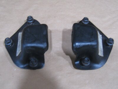

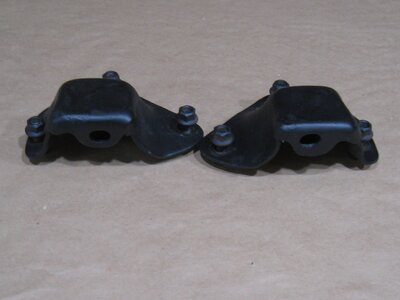

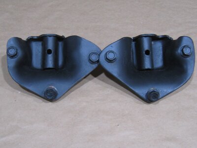

I have a stage 2 engine and HRParts motor mounts and the engine sits too high. In order to get the trans. at the proper driveline angle (3 degrees down) my driveshaft is about 1/8" from the floor right past the trans u-joint. So as it sits I cannot get a safety loop to fit. I plan to take a pair of stock frame mounts and shorten them about 3/4". Anyone else run into this?
