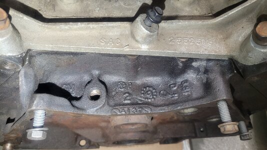

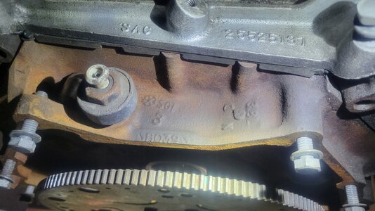

BELL HOUSING FOUNDRY PRODUCTION DATE:
On the top of the bell housing area, near the provision for the knock sensor, the foundry cast the date the block was made. Also, the area shows whether the block was made on DAY or NIGHT shift. All the blocks have this provision.
The '89 SGI block based engine shown below has the foundry marking B039 => February 3, 1989 as well as the tick mark noting D for DAY production. This is a complete GM replacement engine so the VIN pad is not stamped.

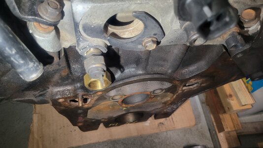

The 109 blocks cast during the 1986 and 1987 model years have two foundry date locations. The bell housing area would be stamped accordingly. Also, the front of the block, passenger side, at the raised spot at the timing cover contains a stamping showing the month and day of the month.
Below is a 1987 production model year 109 block showing foundry mark A137 => January 13, 1987 and N for NIGHTSHIFT casting production.
The foundry date on the front of the block shows A13. See pics below.
RI Engine Block casting date_A137_NIGHT shift.jpgRI 109 Engine Block Front casting date_A13.jpg
The 1985 and earlier blocks will have the bell housing foundry casting date but not the front casting for month / day of month. The '89 109 SGI engine does not have the front casting date like the '86 - '87 model year 109 blocks did.
