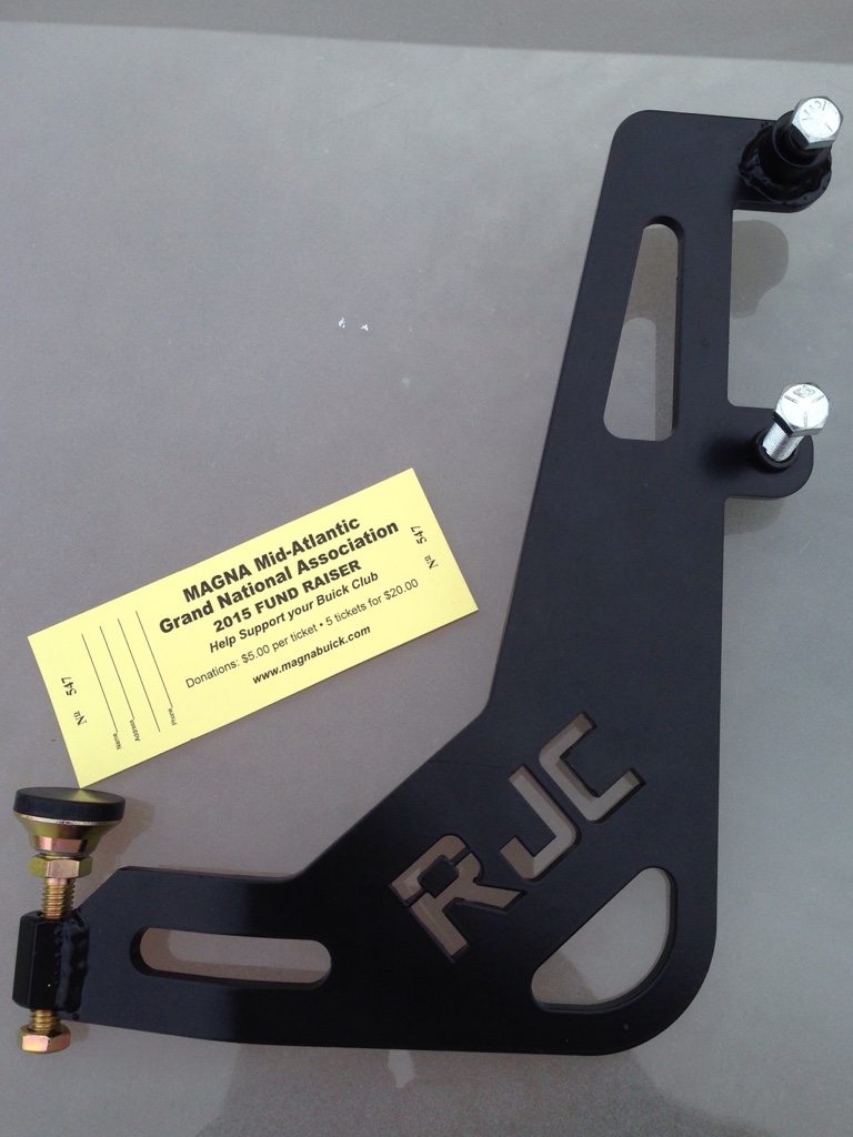

Here you go best spot I can think of!!
Nice, how about I burn it instead and get those poly mounts
Another option is one of these!! Don't mind the ticket but the brace is pretty strong.

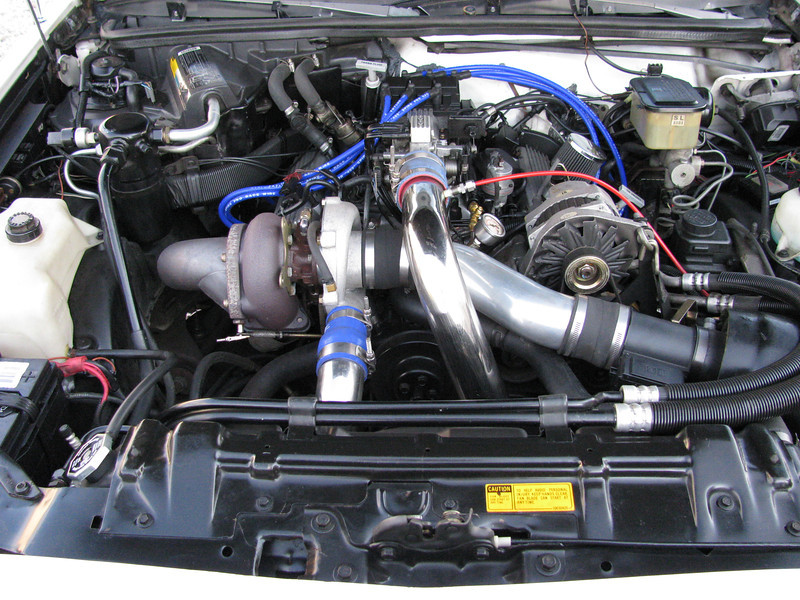

You remove the top bolt attaching the alternator to it's bracket, and replace it with a bolt with an eye in it. Then the ratchet strap gets attached to the eye and one of the holes on the frame down by the DS front wheel. You can make it out in this picture of my white Limited if you look closely...
It's mid-90's TB tech and really has no place on a modern car as it likes to break parts. I took it off this car a week or so ago. You can have the strap and the eye bolt for the price of shipping.
