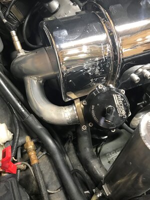

I'm looking to go from RJC internal to a 46mm external wastegate. Upgraded to a Work 6262.
My question is what have you guys figured out for mounting an external to the TA race headers? I see the main "collector" area but that is pretty close to the lower radiator hose.
Any ideas or pics would be awesome!
Thanks.

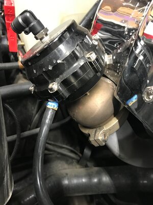

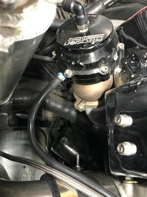

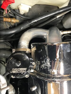

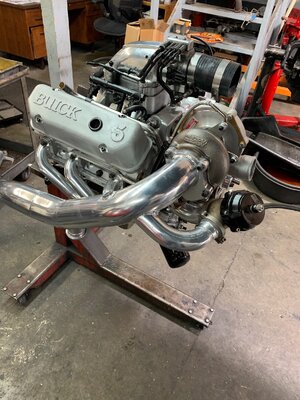

Lou Czarnota did this for me, let me know if you need more pics.

Very helpful! Thanks Guy!
Any chance you have any pics of where the pipe comes off of the header into the wastegate?
If not, I completely understand.
Thanks again.
Awesome!! Perfect. Thanks guys.
Now I can give my guy some pics to go with my request.
Thanks again!
