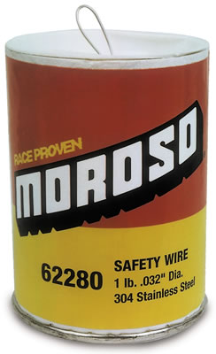

Honestly I would do this.
Moroso 62280 Safety wire.
And these,
Safety wire pliers.
Never have it open again. I would also put some axle grease on the puck and turbine housing hole to help form a carbon seal when the grease burns. It will help keep that hole sealed up under WOT blasts.
