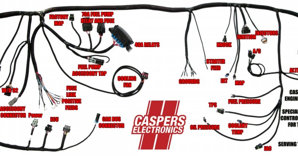

You can update the whole harness if you want considering the age and then specify the connector ends for say a Holley or ECU-GN. If I had to guess I'd say they want a Holley Hp in the car to tune.
There's more to inquire about like, do they know what they're doing with a GN on a Holley etc? This can get very expensive fast.
