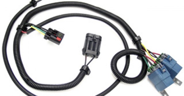

Caspers Electronics offers a plug and play harness. Though I'd confirm with them these are a direct match.
