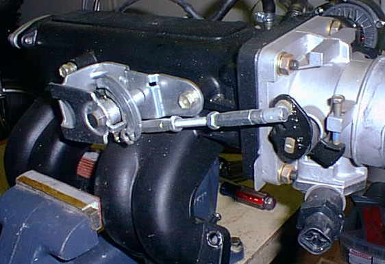

FWIW, I have a FAST bank-to-bank on my turbo Toyota truck, and I run a Ford TB with the GM IAC motor. A couple of firms make adapters to adapt the GM IAC motor to the Ford TB. I personally like the one piece billet adapter made by Precision Turbo (http://www.precisionte.com/). It runs about $50 IIRC, and works great for this application.
You can sort of see the GM IAC motor and adapter at the bottom of the Ford TB in this picture:
If I can get this combo to work on something as off-the-wall as my motor, it should be a piece of cake on your setup.
