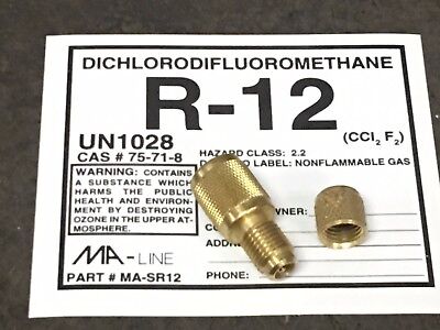

To connect to the high side fitting need an adapter. GM started changing the high side fitting as too many people were trying to charge the system via that fitting (doesn't work). Note that these adapters are difficult to get/find.
On a side note I rarely connect the gauge set to the high side. Too much oil & refrigerant is lost on the connect/disconnect. Only required to see the high side if troubleshooting an issue. Be sure to use a good cap on the high side fitting.
Hook gauge set to the low side, fill, and check the low pressure cycling switch psi.

There is a adapter for the high side port. The R12 hose never fit directly on the automotive port without a adapter. Try to put the low pressure switch back where it was before you turned it. At 70 degrees with R12 35 psi on the low side sounds a bit high. Once you get the pressure switch adjusted see what the pressure is at 2k rpm. It’s good to know both the high and low side pressure so I would get the adapter so you can see if you have problem.

I highly recommend buying the adapter. You really need to be able to see high and low pressures to insure there are no issues or to properly diagnose any issues that may exist.
