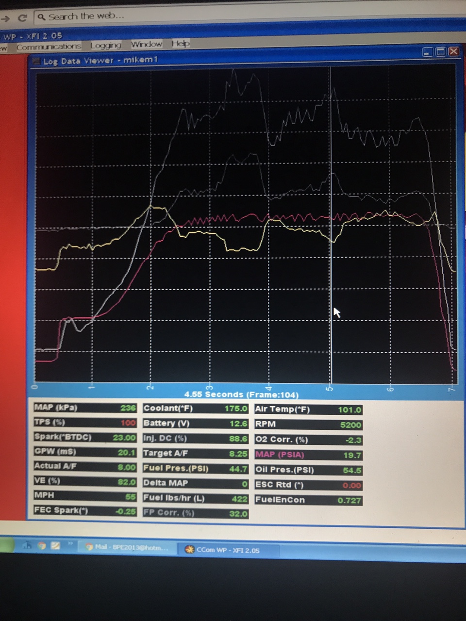

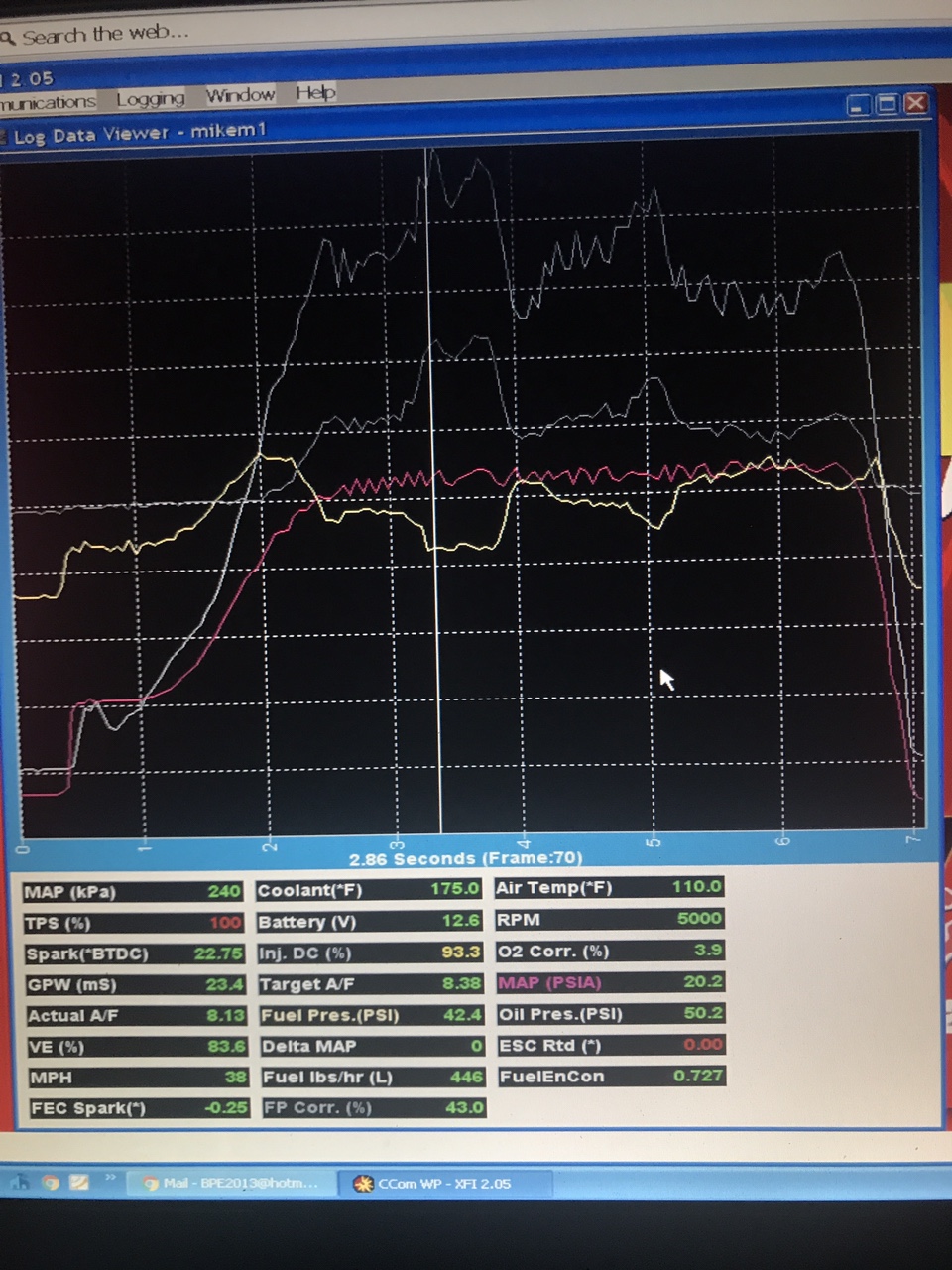

FP correcting in action. Due to pump inadequacy:
Notice O2 correction remains true and VE values remain true since the correction is a proactive real time vs an O2 correction which is reactive. Even with the pump barely putting out more than base pressure at 20psi the ecu was able to fuel the engine and it never went dangerously lean at any point. If you weren't logging fp corr% or inj D.C. Or fuel pressure here you might not even realize there was a problem. This car needs a lot more pump and injector. A single in tank pump with a 62 turbo and good heads on ethanol based fuel. Not even 85% here and the pump can't hack it

I know it's an old thread, but why 8.0 AF ratio? I'm running 11.5 on the exact same setup ...and getting nervous seeing this!
E85? answered my own question...
Correct, he's reading actual AFR on an ethanol based fuel.
The sensor itself reads lamba, which is how much oxygen is in the exhaust stream. The sensor doesn't care about how much fuel you used to get that oxygen content. The ECM or the display device reading the O2 sensor lamba numbers converts it to AFR based on the fuel you're running.
thanks. I've been struggling thinking my Weldon regulator was messed up because it wasn't "boost referencing" but nothing was lean or correcting. You learn something new every day! thanks for replying, I'm so used to older Accel DFI systems, the FAST has incredible capabilities that I never knew about!
