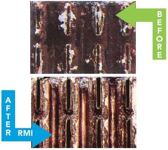

Put some RMI 25 in there and then flush the system.
Lastly replace thermostat.
That's what I would do.
If there's a weak spot in your cooling system, RMI WILL find it.

What RMI-25 does is basically clean out the crap in your system. It does have to cycle for a little though. Here is the link:
