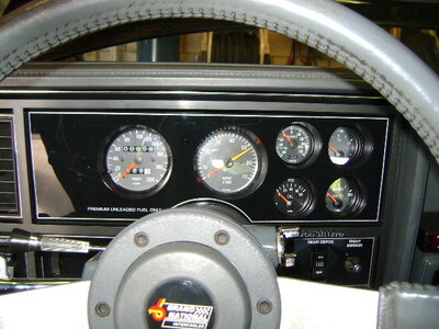

Here’s my install.
GNX reproduction dash with VDO gauges & AVC plug n play wiring harness.
GN Restoration has the GNX dash. That is where I got mine.
Just posted a thread asking specifically wich Stewart Warner gauges are used in the dash.. series/model # / part # do u or anyone know?
Nope, no idea…..but good luck finding any cause they’ve been discontinued for years
