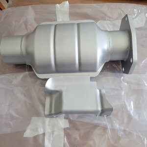

1986 Buick GX1 GX1 #001 [The One and Only] Joined Apr 24, 2015 Jun 3, 2024 #3 Weld a flange on one of these. Catalytic Converter Check out the AllFlow Catalytic Converter! www.siliconeintakes.com

1KWIKSIX Well-Known Member Joined Sep 29, 2007 Jun 4, 2024 #4 1986 Buick GX1 said: Weld a flange on one of these. Catalytic Converter Check out the AllFlow Catalytic Converter! www.siliconeintakes.com Click to expand... Yup, this is exactly what I did & Love it

1KWIKSIX Well-Known Member Joined Sep 29, 2007 Jun 4, 2024 #6 Big H said: Thanks man I just ordered one of these!!! Click to expand... Be sure to measure the OAL of the cat you’re removing . I had to have a short stub of a few inches added before they welded on the 4 bolt flange in order to match the length
