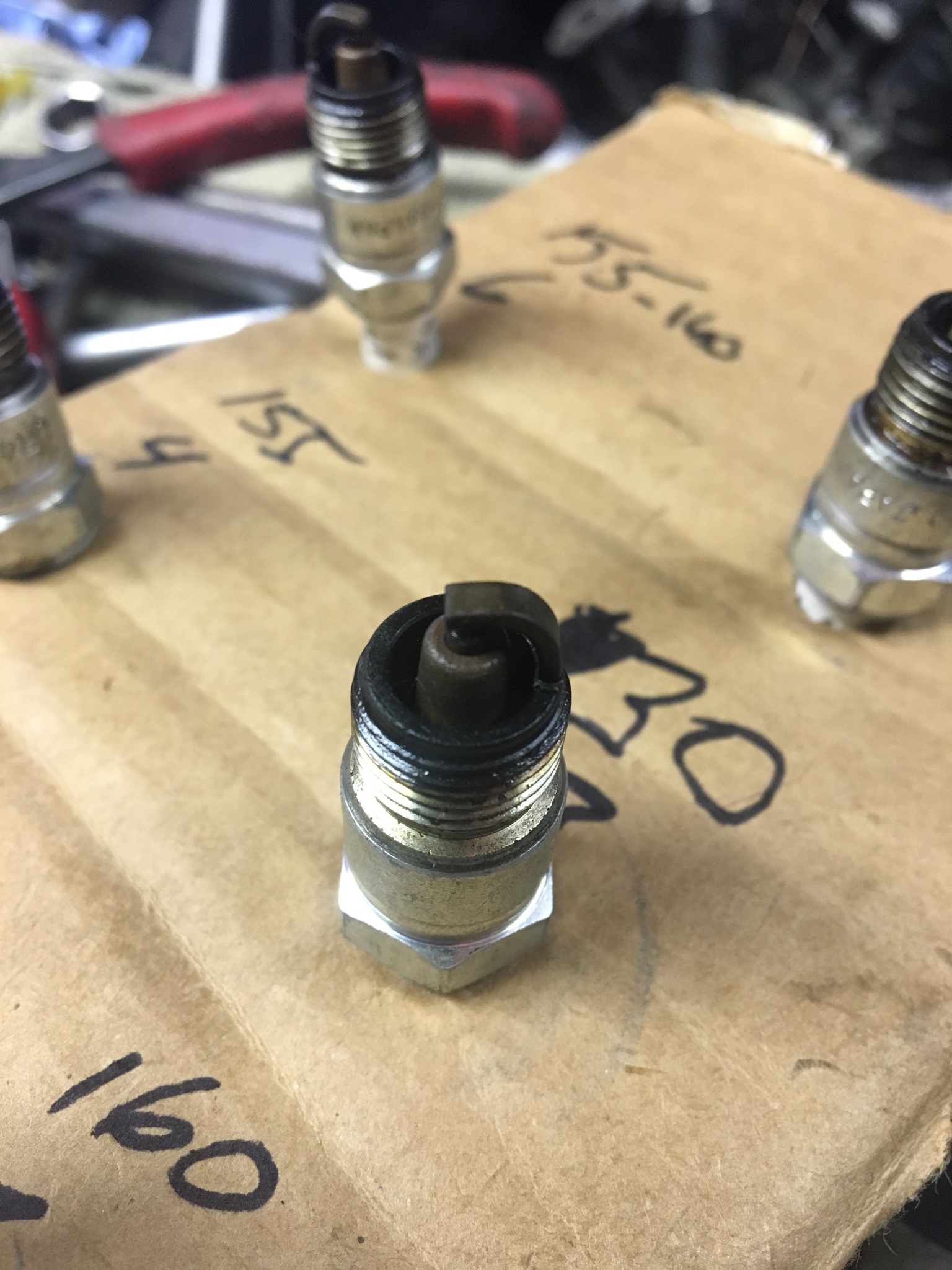

What did the plug look like?
Looks a little fuel soaked, more than likely I'll need a rebuild now... stroker time

Attached a picture, I blame it on the egr valve which burned my harness.. and myself for not paying very close attention. Time to make it faster.

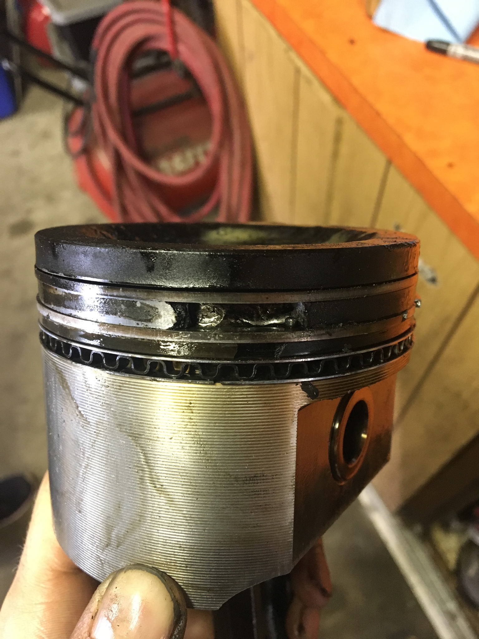

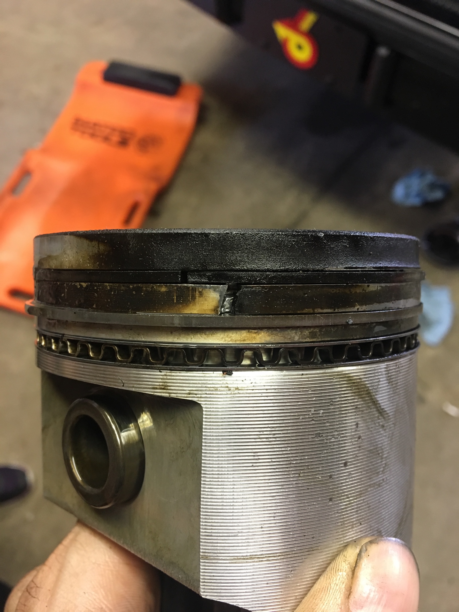

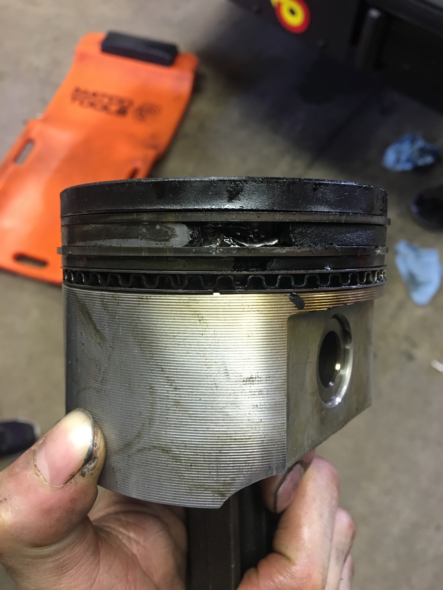

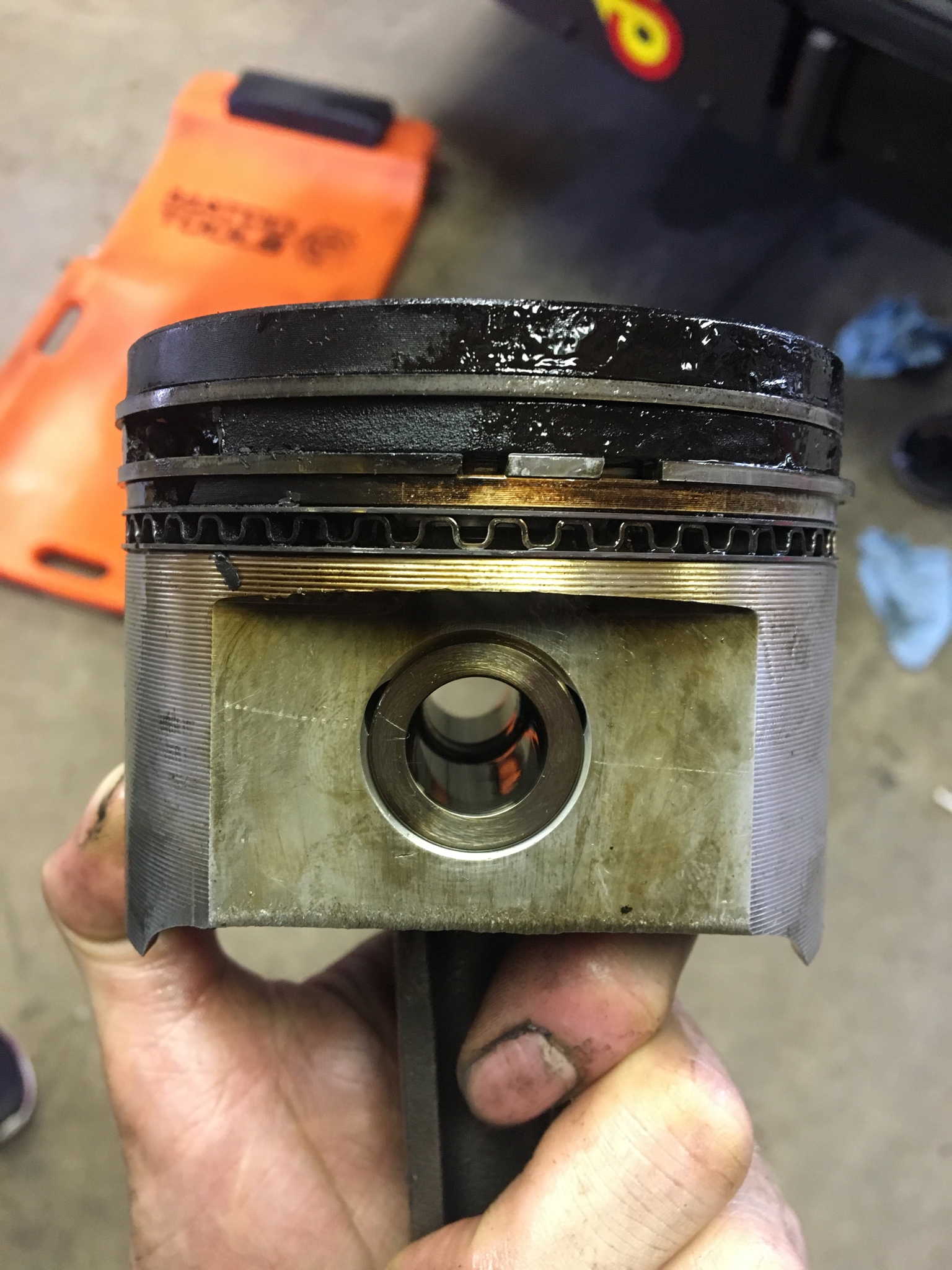

Well decided to take the oil pan off and pull the piston for the hell of it... this may be a problem, I figured it was this in the long run...
Chuck's the first winner. Earl comes in second. Others were close but not specific. :D

That's one horrible looking piston. What brand and type is it?
and do you know the bore size? I'm curious on the piston to wall clearance.
