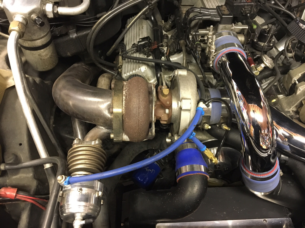

Trying to figure out why it's overboosting/spiking, which I'm trying to figure out now. It's running better than before but not quite perfect.
Run a brand new hose with zip ties from the turbo straight to the wastegate and see what that does.
Internal or external waste gate ? Might have to port the exhaust hole on the turbo housing to get the pushing pressure out of the housing faster/easier.
I would also HIGHLY recommend a magnetic drain plug.
Ok, take out the rjc controller out and just run a hose to it right?
I have a magnetic drain plug already.
I've been hearing that also, it is a external wastegate, anyone tell me what brand it is?
I've eliminated the y fitting going to the factory solenoid and running it from the compressor to the controller then to the wastegate.
