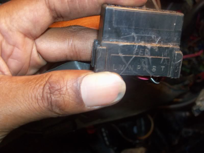

101_0900.jpgWhere does the white plug on back of the cluster plug into?

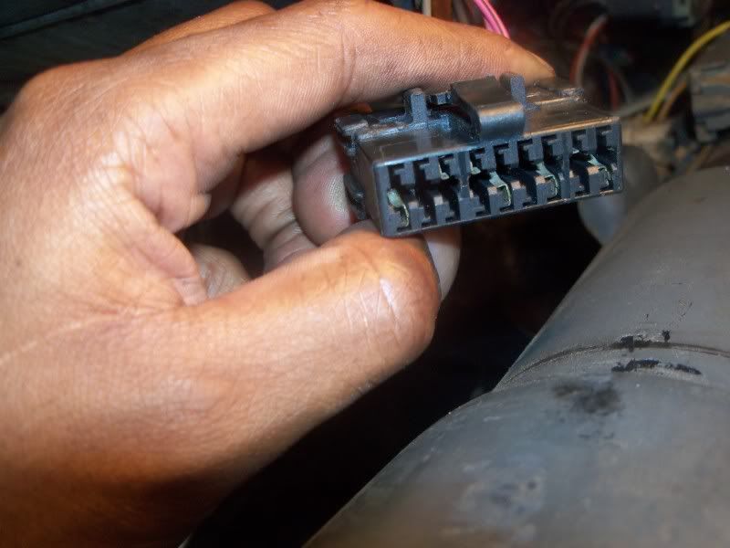

Where does this plug goes and the light?

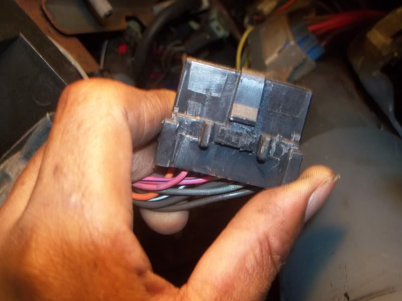

And one more plug that was under the dash?
http://i24.photobucket.com/albums/c16/decaturforlife/fulton1/101_0917.jpg
http://i24.photobucket.com/albums/c16/decaturforlife/fulton1/101_0914.jpg
http://i24.photobucket.com/albums/c16/decaturforlife/fulton1/101_0913.jpg
white plug from cluster plugs into dash harness behind the black plastic cluster mounting bracket.
not sure about the second brown or black plug.
white light socket plug plugs into back of cluster for service engine soon lite.
cant see enough of last plug to tell where it goes, if you dont get an answer by morning i will look at my car when i get home.
First picture is the C100 connector.
Picture 2... I honestly have no idea what that is. Is this an analog dash? That might explain some things. I have a digital dash and have nothing like that.
Picture 3: The plug I can't honestly tell, if you could pull it out a little bit more so I can see wire color I might be able to hazard a guess. The light is your Service Engine Soon light, just plug that into the actual dash.
Pictures 4+: That honestly looks like the digital dash connector that would plug into the back of the dash. But that leaves me even more confused about the first connector.
