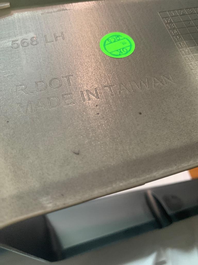

here's some head light bezel pics ... I have a sealed in box grill im not gonna open ...but the made in Canada stamp molded in is the dead give away...rivets on top of grill are black on factory originals ...and retooled GM ones from 2000's are silver ...
Yes your best bet is find casting part# on parts. OEM Headlight bezel or much lighter and a tad thinner than repos. If parts have been just laying around for a long time there is a possibility the bezel at top center will be drooping.
So most of the new reproduction parts are stamped wait for it Made in Taiwan!! Aka China!!
