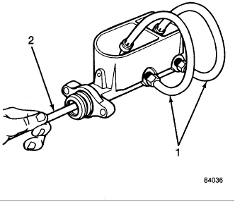

No didn't do that. How that process go? I'm not a mechanic I just know the bleendinf process with the brake pedal
The picture is self explanatory but you need a set of hoses and fittings. Looks like advance sells a nice kit. http://shop.advanceautoparts.com/we...s-Dorman---Help_22142388-P_N3378_T|GRP2007___
The hose ends need to be under the fluid. Slowly pump the brakes until no more bubbles. Again go slow. It will shoot fluid out if you go fast. When it's good hook up the lines and bleed the rest of the system.

you always - ALWAYS- bench bleed a master cylinder before putting it on the car.. it's not that hard and only takes a couple of minutes to do. they used to put a bench bleeding kit in the box with every new and reman master cylinder, but they decided that it's better to save 50 cents on each one and not include them any more. but they should still have an instruction sheet in the box that tells how to do it, and i'm sure there are more than a few youtube videos out there that demonstrate how it's done.

Man I sure didn't kno that. So what's that on number 2? A rod you use to push? Or can I this with it still hooked to the booster and pump the brakes. Or does it have to be off?
you could do it in the car- if you jack up the back of the car to get the master cylinder perfectly level and if you have a way to slowly push the pedal down while watching for bubbles... but it's so much easier with it clamped in a bench vise using a large philips screwdriver to push the piston in..
I bled mine on the car. Just have to be gentle, I was told not to stroke the pedal all the way down. I stood at the master cylinder while I had my daughter ease the pedal down until I told her to stop and hold it. Then when I saw the bubbles stop I had her release it to go back up. Safety glasses, very important if you have helper that doesn't follow directions well or you could get squirted with fluid. We bled for at least 15-20 min. Then moved on to the wheel cylinders.
