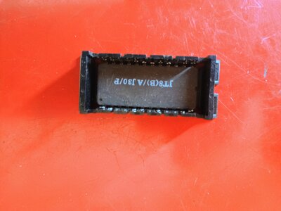

Can you please help me identify this chip? It could be a stock chip. Thanks

Back in the late 80's early 90"s guys in the Electronics Lab at Rochester Products ( home of the QuadraJet carb ) were cloning HyperTech chips and selling them for half the price of HyperTech's . I had one in my GN and this could be one of them . The label looks like it is from a Brady label maker which we used at Delco Products & Rochester Products .
I came across the cloning equipment when my wife took over the Electronics Lab in 2014 .
My stock 87 chip has markings on the back with JT8(G)AA29/P. And the questionable chip also has similar sequence. What do these digits mean?

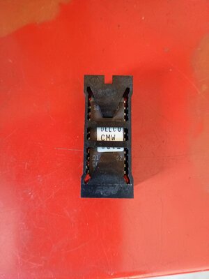

CMW is the broadcast code for the eeprom used for the factory LC2 engine in '86 models.
Attached is a spreadsheet that lists the GM broadcast codes from about 1985 to 1996 with their respective applications, prom id's, ecms, etc.
