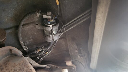

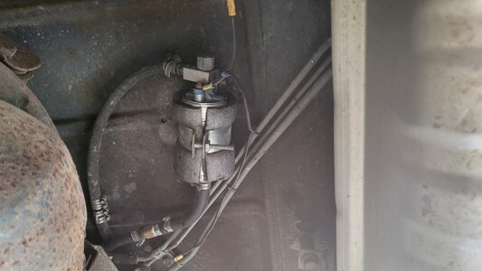

I got this 87 regal turbo and this is behind the gas tank. Is this a fuel pump? Please help with info.

Looks like an 044 bosch unit. Old school, I have one like it on my og T. Disconnected it when I went to a Red Armstrong in tank unit.
I had the old Bosch pump too. It was one of the first upgraded fuel pumps available. I believe Red’s XP was the first in-tank pump upgrade.
Unfortunately there’s no way to make it an in-tank pump.
You’ll want a hot wire kit anyway, it adds a heavy gauge wire off the alternator stud to feed the in-tank pump plenty of power for reliability.
Full throttle has you covered with SS 255 lph fuel pump and hanger assy.
And hot wire kit.
They have the special sending unit resistor available if you have a Digital Dash.
No matter what, that pump needs to be removed. Then drop the tank and see what's left on the intank pump hangar.
The last step, is to order a completely new pump and hangar assembly and replace all of the rubber hose butchering you have going on with that Bosch 286 series external pump.
