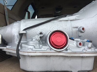

It got a "fancy" servo and they left out the spring. This causes the downshift clunk you are experiencing. What servo was installed?
That play is normal. Depending on the mods done to the trans the 3-2 clunk could be caused by several things including removal of the cushion spring in the intermediate servo. What servo was installed....stock or aftermarket? A picture of the servo would help.
here is a picture of the servo. Looks like a Sonnax?
Also , Just to add , I did install a Driver side only HR Parts engine mount. I know they say they are stiffer .

What they 'all said about the cushion spring being left out of the servo. The clunk (thump) is being caused by the transmission locking up for an instant (it is in both 2nd and 3rd at the same time). This stops the drive shaft for an instant which takes up the slack in the rear. Hence the clunk. I still don't understand why builders think this is OK.
I don't, so I added the cushion spring. Sure beats sliding the shifter into neutral before the automatic 3-2 shift occurs. What ever you do don't try a manual 3-2 shift, damn was that brutal. Only did that once prior to adding the cushion spring.
